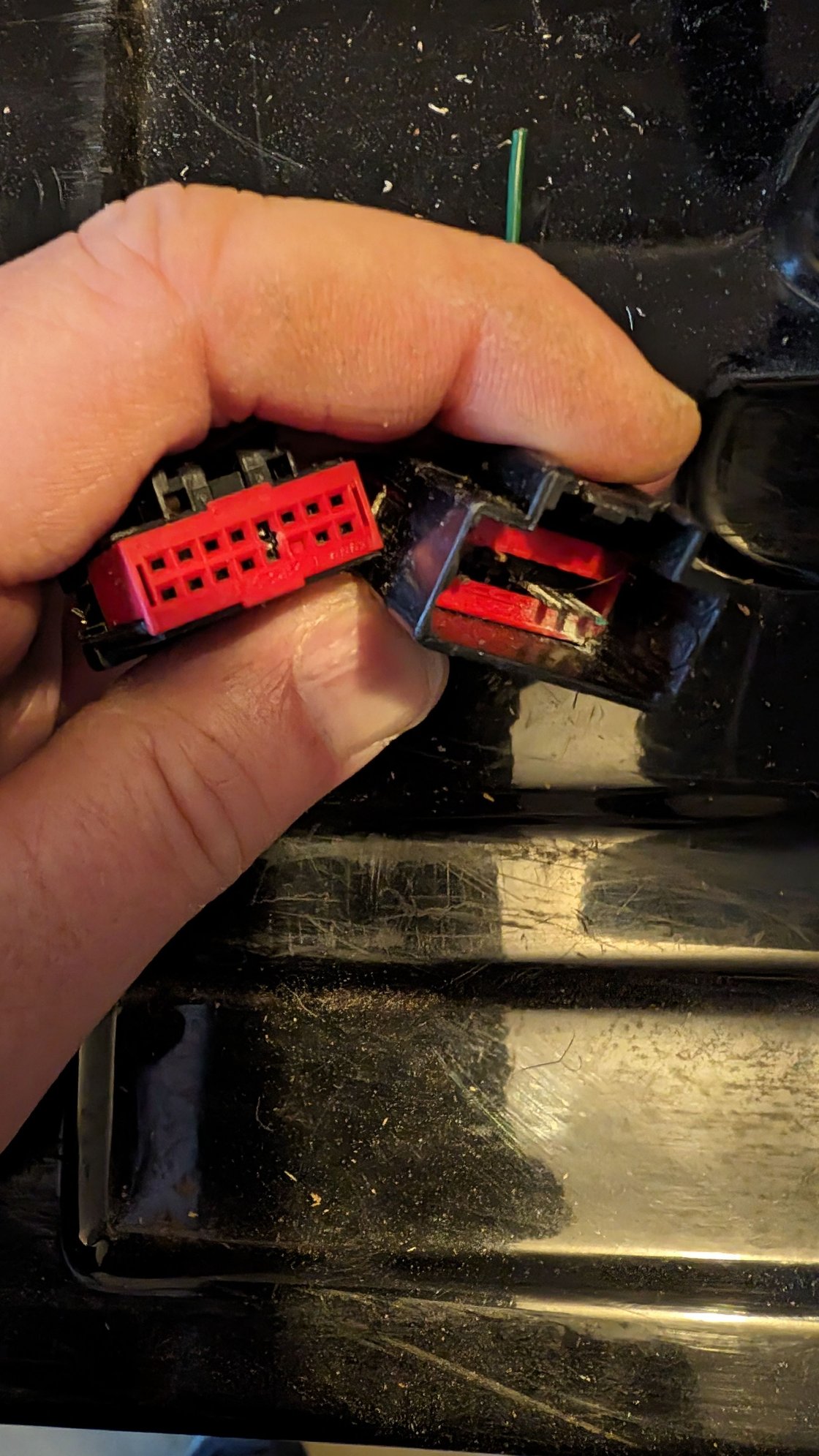

Turns out I had taken a pic of the connector when I pulled it, and water-induced corrosion was immediately revealed (you can see the green crud on the pins). This is connector that was a problem for me, US passenger side footwell.

I just replaced it with a 12-wire pigtail connector (male and female, with wire leads attached) I got off Amazon, and just soldered it in place. If you troubleshoot it down to a particular wire (I would start with the black grounds), you could just bypass the connector by soldering in a new wire around the connector. While you would lose the 'disconnect' feature of the connector, the connector isn't something that would regularly be disconnected.

Well I'm not sure if this will fix the problem but it must be addressed. The entire harness under the US passenger side is all corroded and crumbly from years of a pillar leakage. I'm going to address the leak, dry out the carpet and padding and rewire it all with fresh wire all the way and delete the connector. Hopefully it resolves my issue, but needs addressed regardless.
