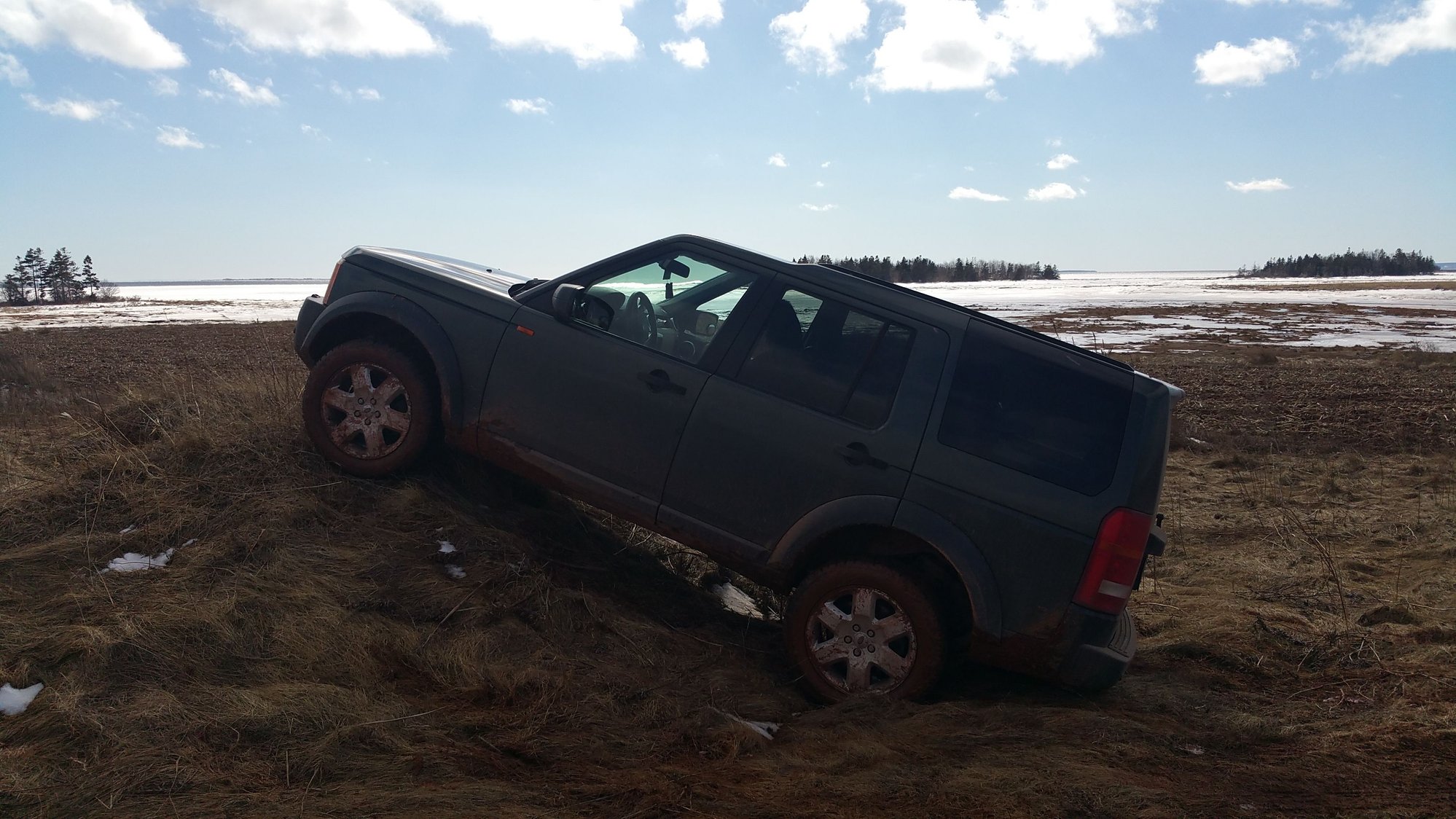

@PEI PAUL what do you mean by your caption? OME? You have an Old Man Emu lift on your LR3? I've never seen one sold. Ever. Also, you have a 2" lift but are running on street tires (from what I can tell). That should be your first move, tires and sliders...not bumpers.
(Maybe that's an old pic)

No they are my winter tires on my 19s that I use for snow, I have 18s with mud tires for playing.
Yes I removed the nightmare air suspension and replaced with shocks and old man emu springs 2" over standard air ride height.
