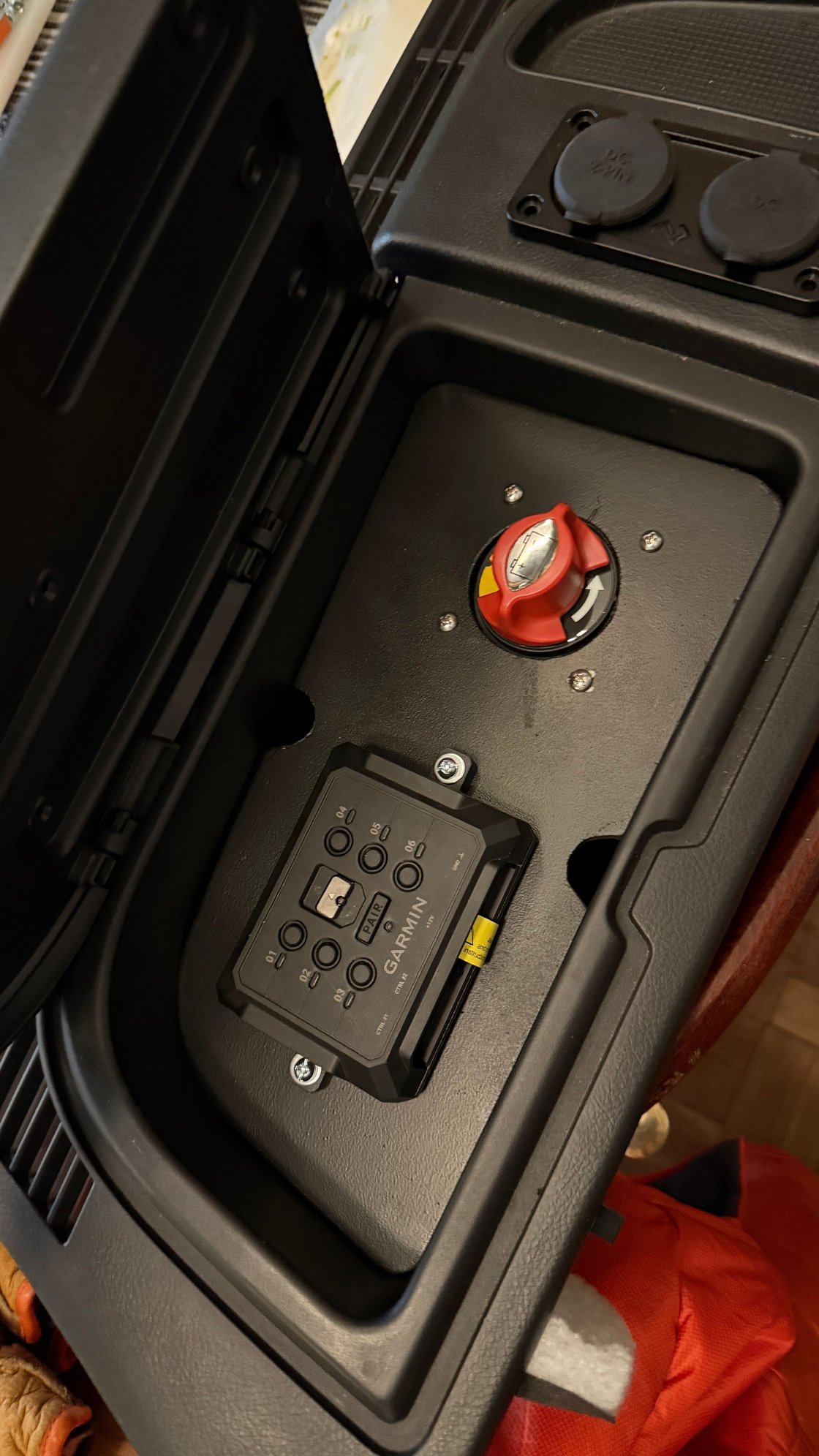

The command center for the operation will live within the driver side rear cargo cubby - see below. I've templated out and created a panel that sits within the cubby, on the top of which is a Garmin PowerSwitch as well as a cutoff switch for the aux battery system. On the underside will be a fusebox and a bus bar for ground.
The actual control for the system will be via CarPlay as Garmin has an app that is CarPlay compatible.

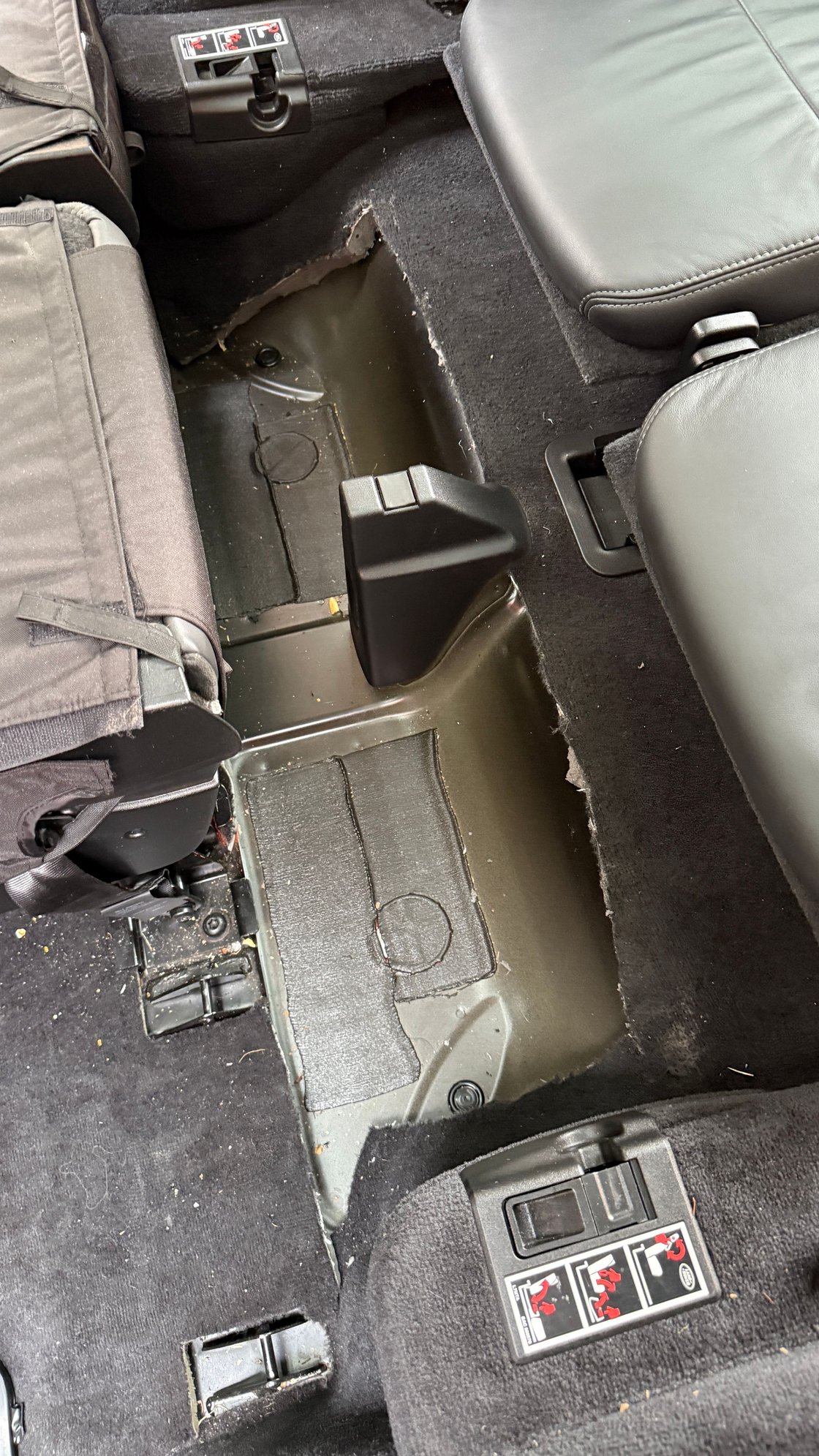

Heres where the batteries will go at the footwell of the third row seats. I’ll build out a carpeted enclosure above and in front of them. The inverter will also live here below the middle seat in the second row.

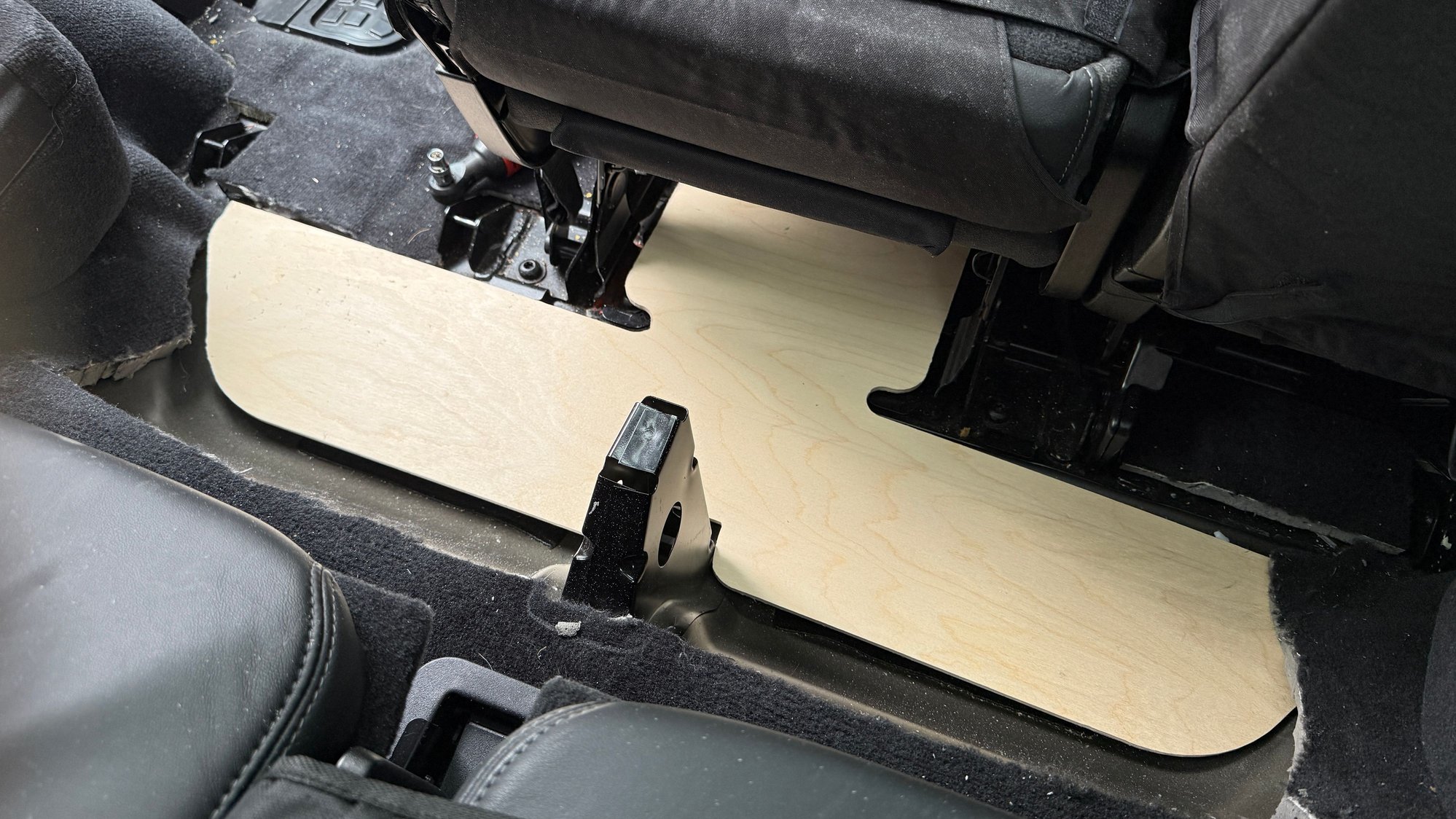

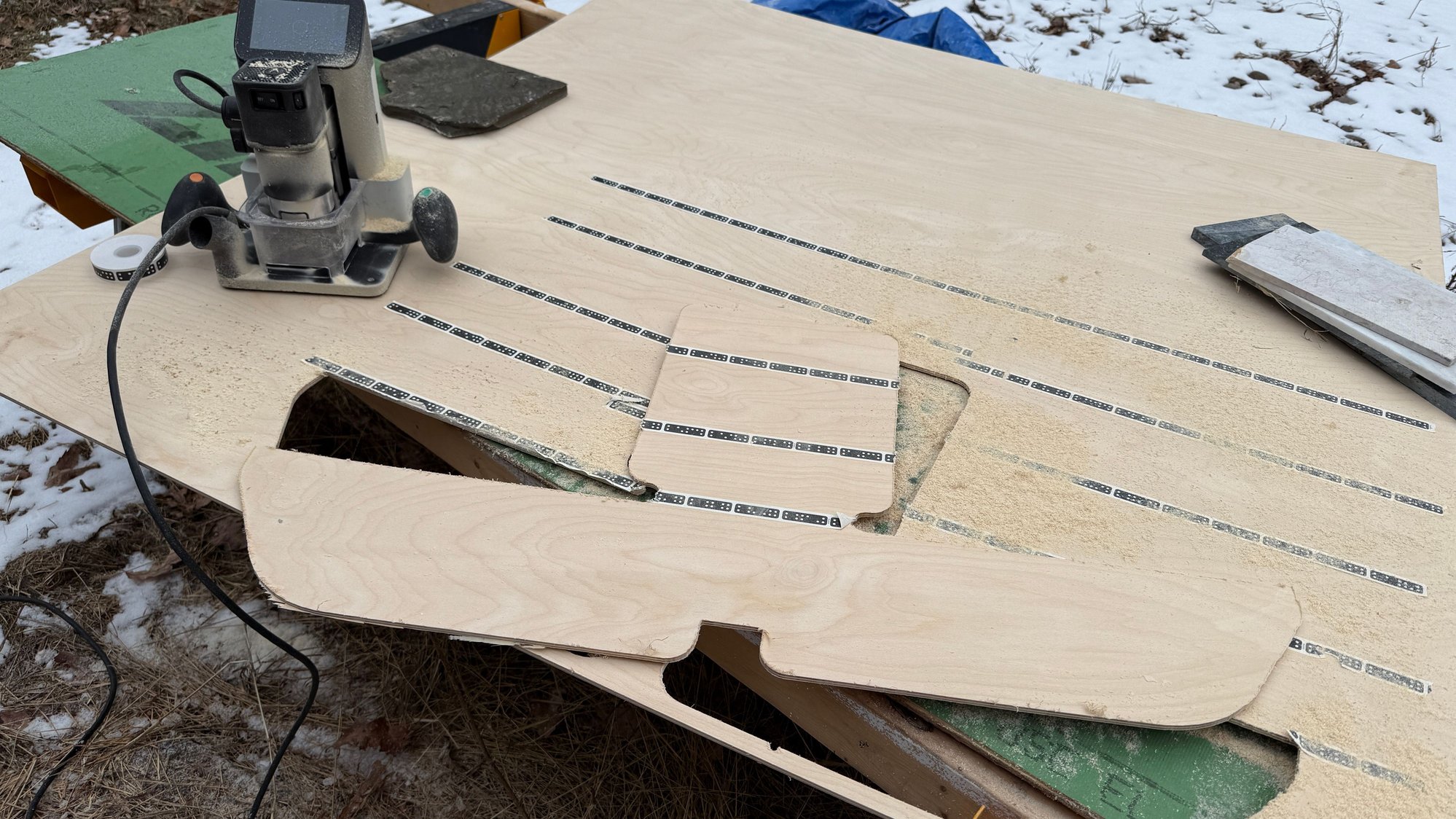

Still a bit of carpet/sound matting to trim, but I was able to template and cut the "tray" for the batteries and inverter.
