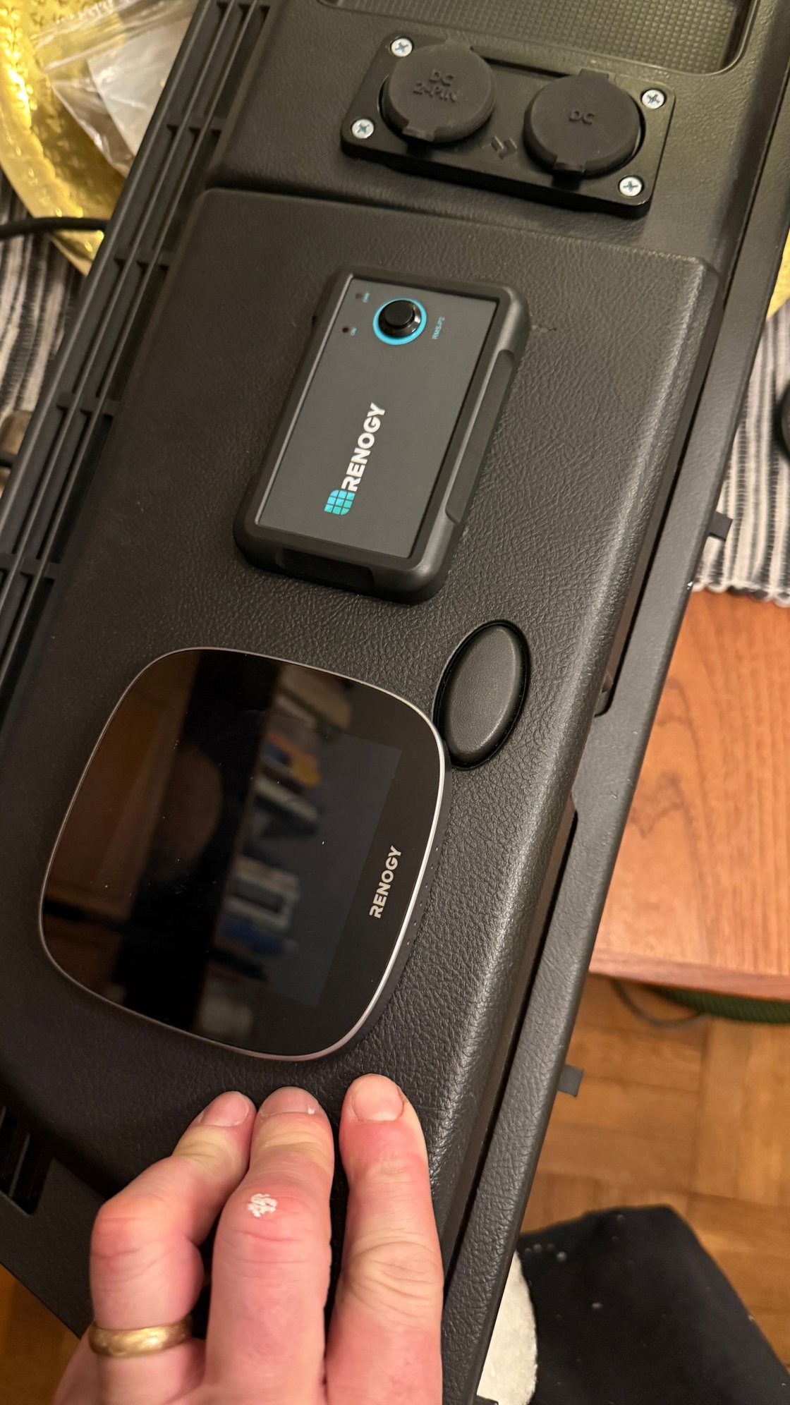

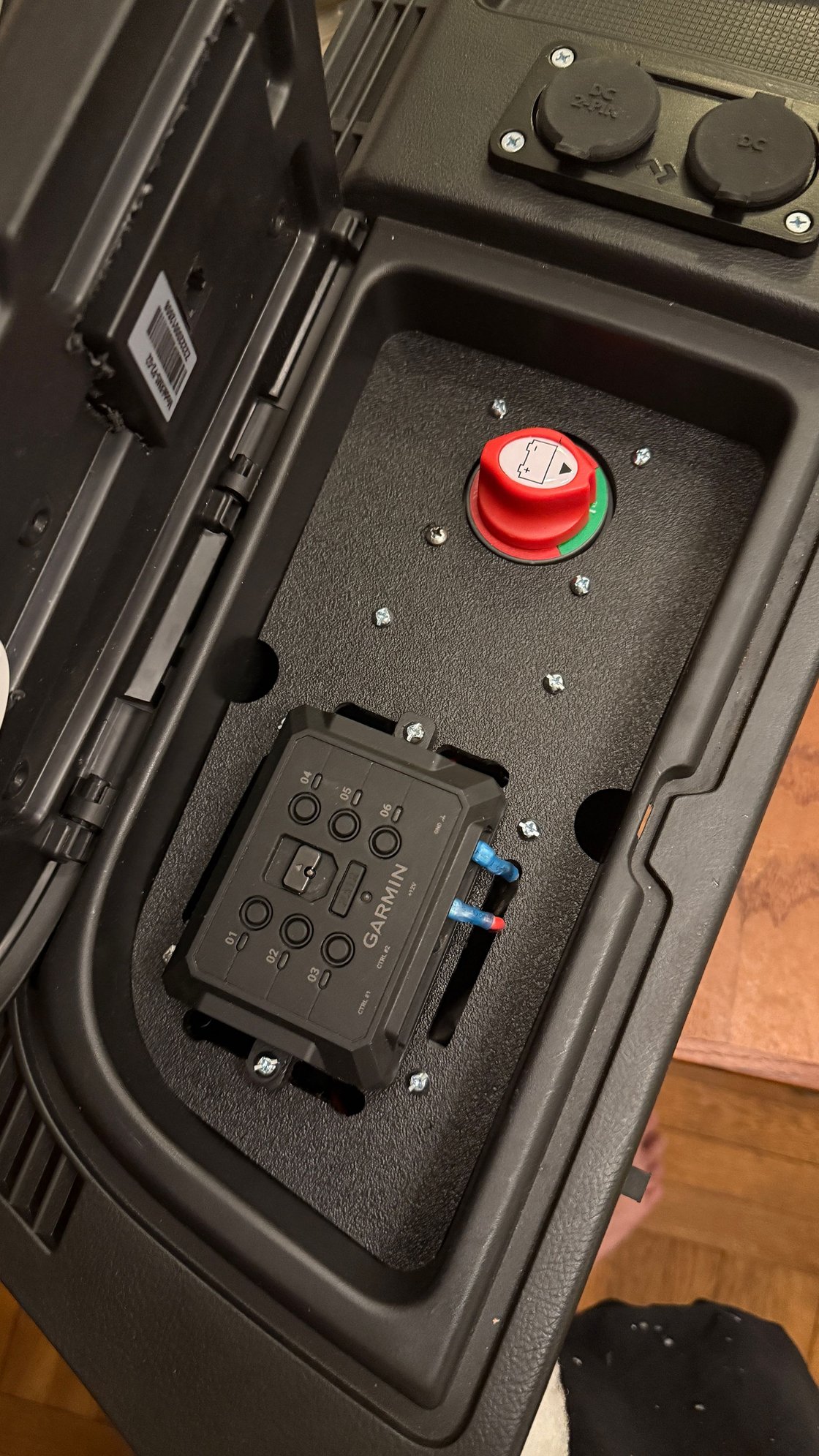

Finally some more progress. Got the final version of the cubby mounting board done and starting to get everything wired up.
I've placed connecters for all equipment on short tails from this compartment to make wiring up inside a breeze, then I just bring it to the truck and get it all plugged in and the panel re-installed.

And the underside of said panel
- Two BlueSea Ground Bus Bars - Overkill, but allows for better and tidier connections.
- One 4 Fuse BlueSea Fues Panel
- The underside of the Disconnect.
