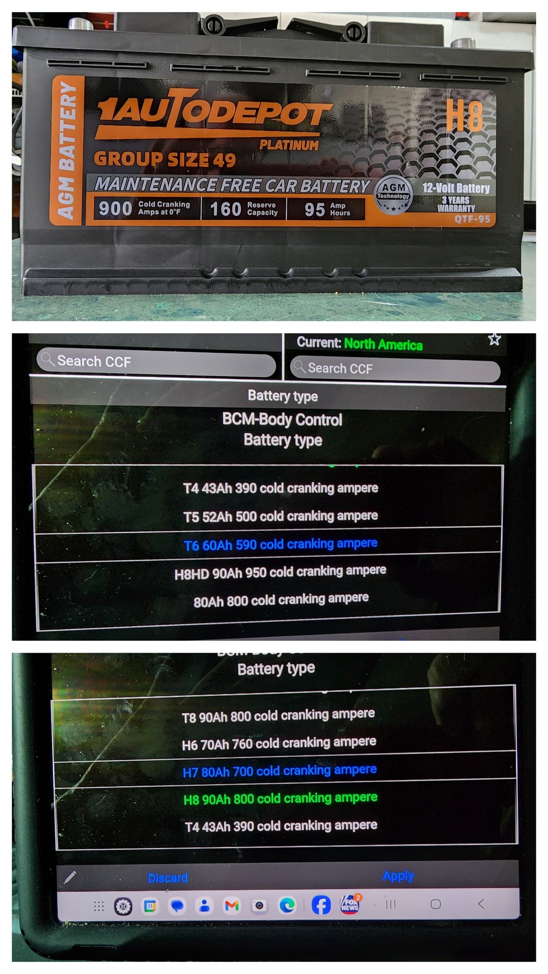

Looking for some feedback from the braintrust here. Recently installed a new battery, and besides telling the BCM I had done so, I checked the CFG file to change to the new ratings. Unfortunately, the CFG only has 2 H8 options - well an H8 and an H8HD. Unfortunately neither are exactly correct on the CCA or Amp hour settings. The H8 setting is low on both values, whereas the H8HD would be low on the Amp hours but rated higher for the CCAs. So the question is which option will be better for the Alternator and ultimately battery life longevity and electrical system operation? As always, TIA for any & all feedback.

Thanks Guy. Appreciate the feedback (here & there). Had noticed previous battery (4 year old Delco H8 AGM) was always charging in the 13.5 - 14.8 range in my digital monitor plugged in at the console power socket. Thought that was OK, but realizing now it was probably only half a step away from falling into the battery graveyard and potentially taking various electrical systems into said grave with it! New battery might go to 13.2V for first minute or so of driving but backs down to the 12.5 - 13.0 range for most of my local trips. I've read in other posts this would be "normal" due to the "smarter technology" of the BCM/Alternator/AGM combos, and the alternator doesnt have to be charging at a higher 13.5 - 14.5 rate all the time anymore. Makes us OLD GEEZERS worry a bit when we dont see the alternator cranking out a steady 14Vs all the time as it "used to be in the old days"!! 😉 LOL. Still learning after all these years.
