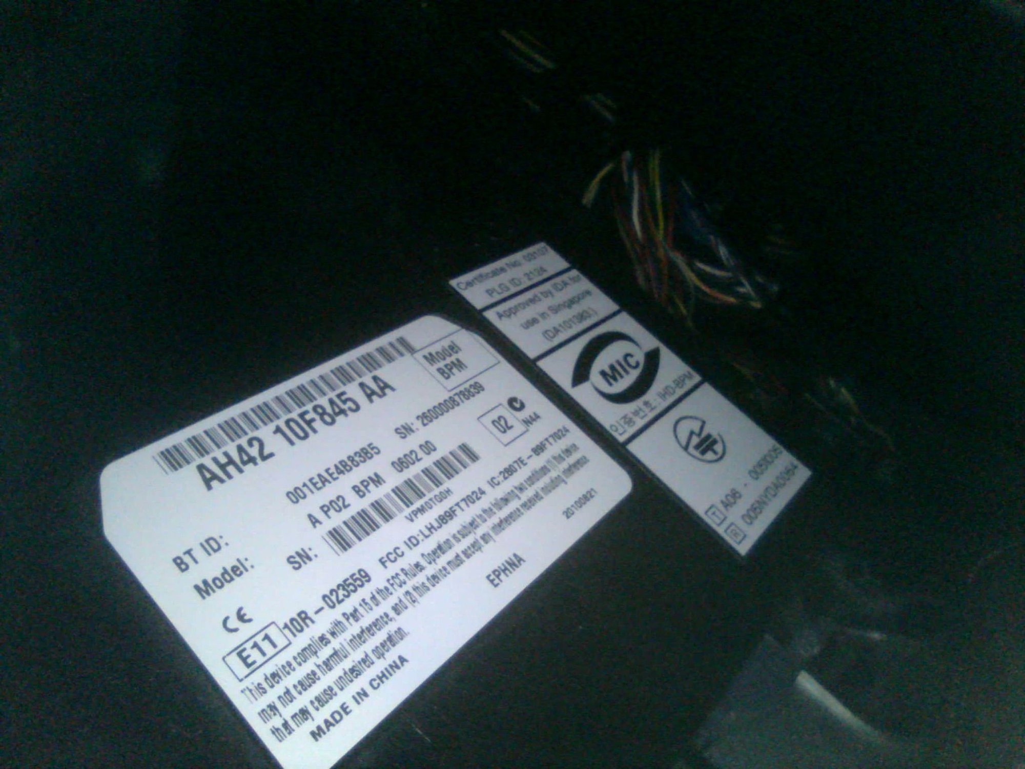

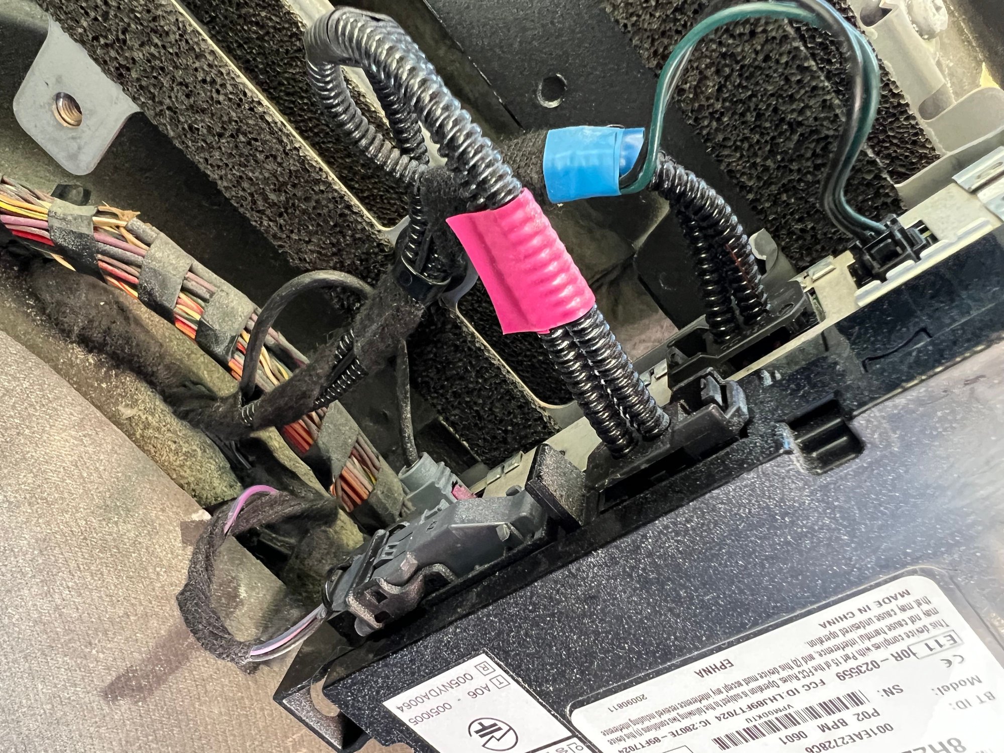

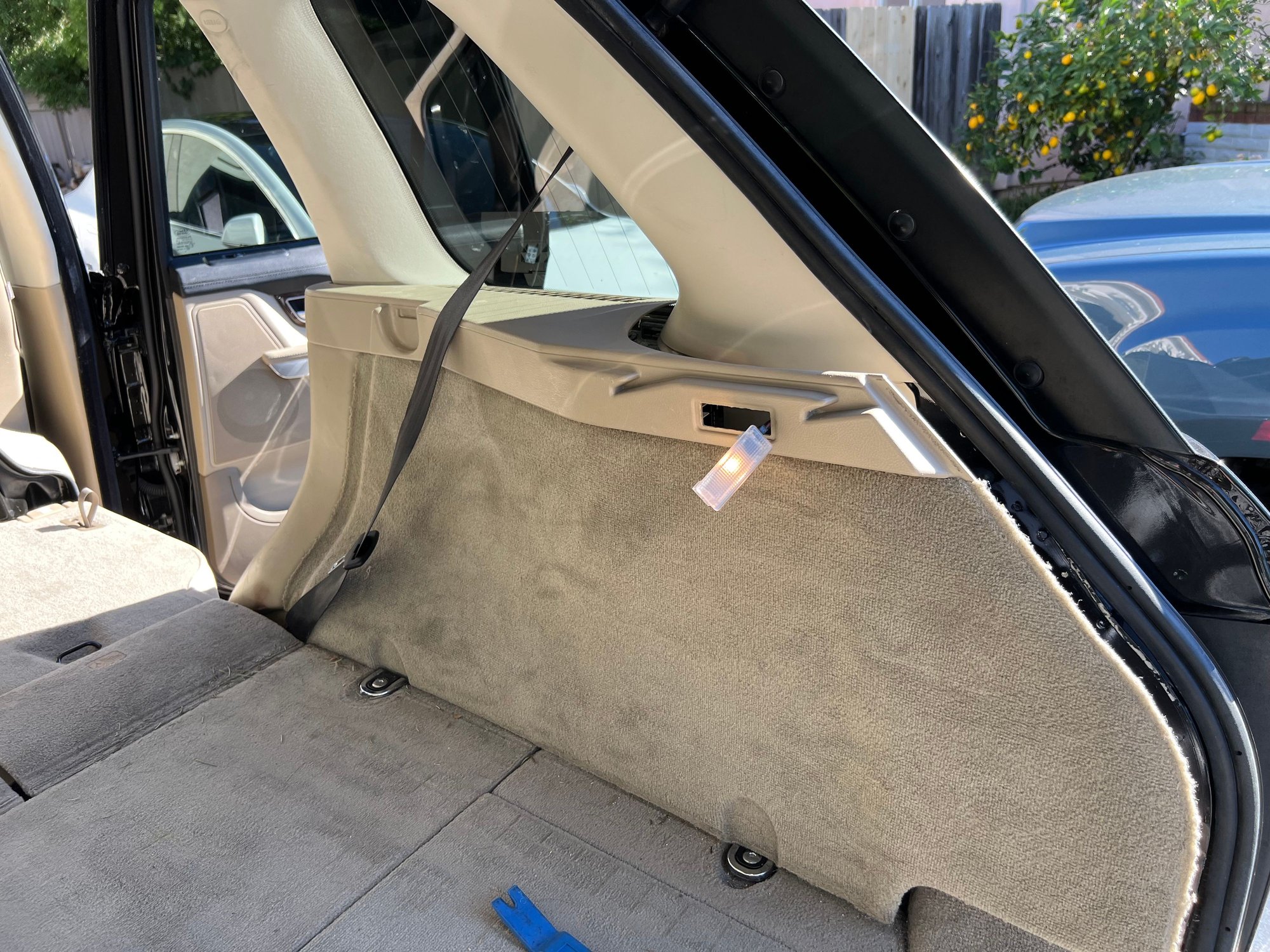

Originally Posted by Daytonars7
Not sure if you ever solved your problem, but I recently had the same issue that "land rover" wasn't showing up as an available bluetooth option on my phone.
Solution was to unplug the bluetooth module and reconnect it.
The module can only pair with soo many phones, after it is full, it is no longer discoverable. As far as I know, there is no way to delete old phones through a menu.
Module is located in the back right, inside of the side panel just in front of the cubby bin. Removal of some screws, weatherstipping and pillar panel is required in order to move / bend the panel enough out of the way to disconnect the plug.

My kids were in town for the holidays and used my 2010 Range Rover Sport for the last two weeks. I got in the truck on Sunday morning and no phone connectivity (although it did have 3/4 of a tank of gas!). I got the same message on the screen about "If your vehicle has the phone feature fitted, please pair and / or connect you phone" I tried entering a pairing code, but there isn't a way to do it. I tried the "talk" tab on the steering wheel, nothing. Any ideas? I don't have any codes. I plugged in my Gap Tool but couldn't find anything that was helpful. 2010 Range Rover Sport HSE 5.0. Has anyone had success with unplugging the bluetooth module? Thanks Phil
Old Jan 6, 2024 | 01:59 PM
  #29
ljdiscovery's Avatar
Joined: Jul 2007
Posts: 1,227
Likes: 48
From: La Jolla, California
Success. I unplugged the Bluetooth module, plugged it back in and now I have Bluetooth back! On the Range Rover sport the Bluetooth module is behind the right side rear panel in the cargo area. Love this forum! Saved me again.
