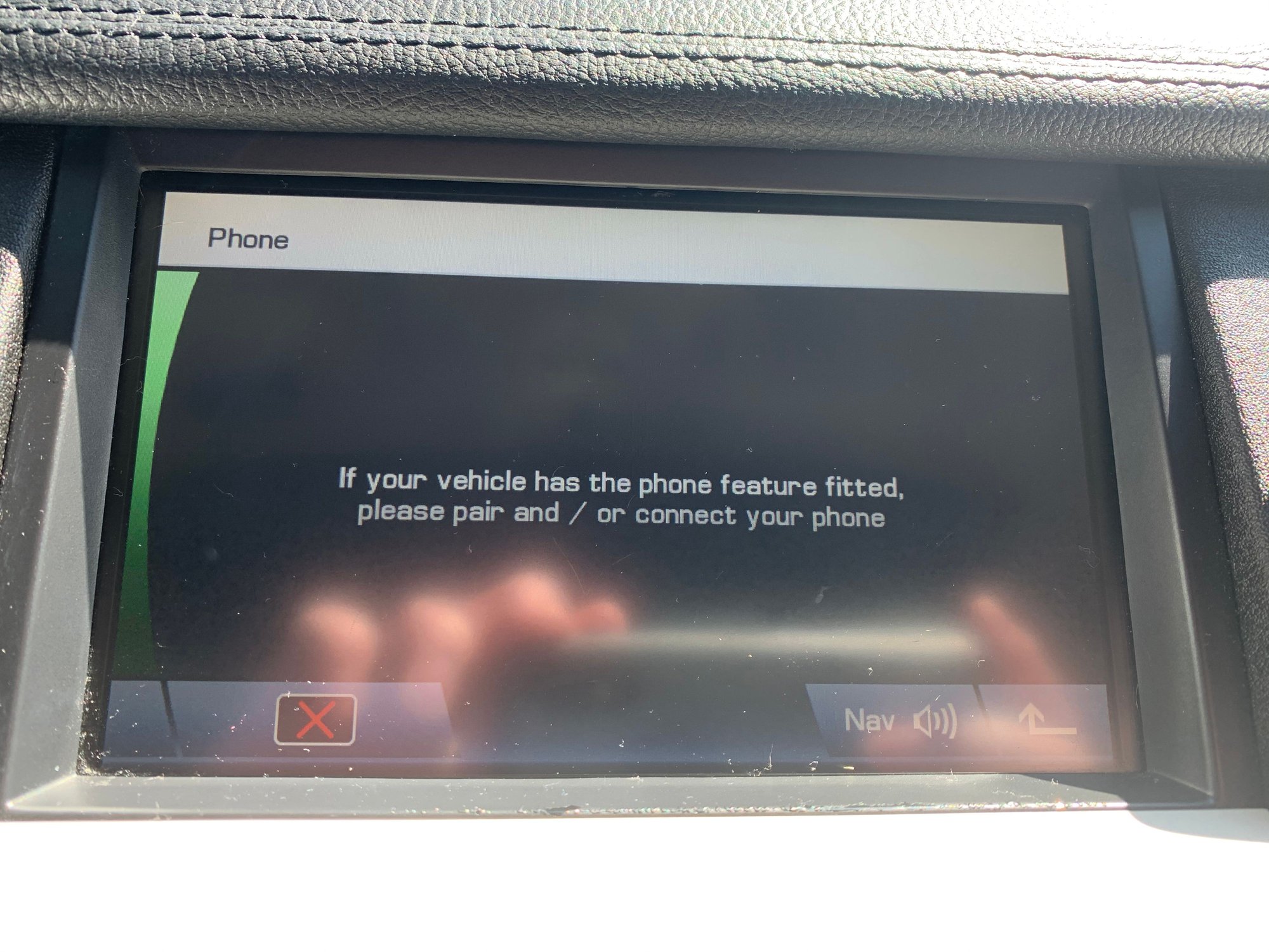

Thank you guys for the great info so far. I pulled the battery and the fuses for both Bluetooth and the radio overnight and reinstalled everything this morning. It didn't seem to do anything to the Bluetooth screen that has been there from the start and had no effect on the bluetooth connections from my phone. I've attached an image of the screen, I'm really starting to think that this car doesn't have bluetooth phone capabilities. I can play audio via the Bovee that is plugged in to the iPod slot under the center console, but that's about it. Any other thoughts? Is there a land rover accessory that I need to purchase in order for this to be capable on a 2011 HSE model? Can I reset any settings with the GAP IID tool? @LR Techniker, how do I make the vehicle searchable through the infotainment? Thanks all!

BT audio and phone are of course separate channels. It could easily be a phone issue, try another phone just to be sure.
Your display would indicate that your module has never been paired, which I think yours is saying its not. If it has been paid then you would get the phone system pad, etc "phone not fitted" instead.

So I got into the Bluetooth module today. Disconnected both wires that run into it and reconnected. The bottom wire gave me a low battery fault and the top one didn’t do anything. I’m assuming the module has gone bad, correct? Is the MOST system something that ties into Bluetooth? If so, my GAP tool says that is not configured on the vehicle.

The BT module is literally a radio into the MOST. If the module was 100% dead then the MOST ring would fail too since its part of it. So the module must have some functionality yet. The BT radio could be toast. But if the GAP tool says its not configured, I assume you mean via the CFF, then its possible the module is "disabled" right now. If you configure the module ON then it may work.
