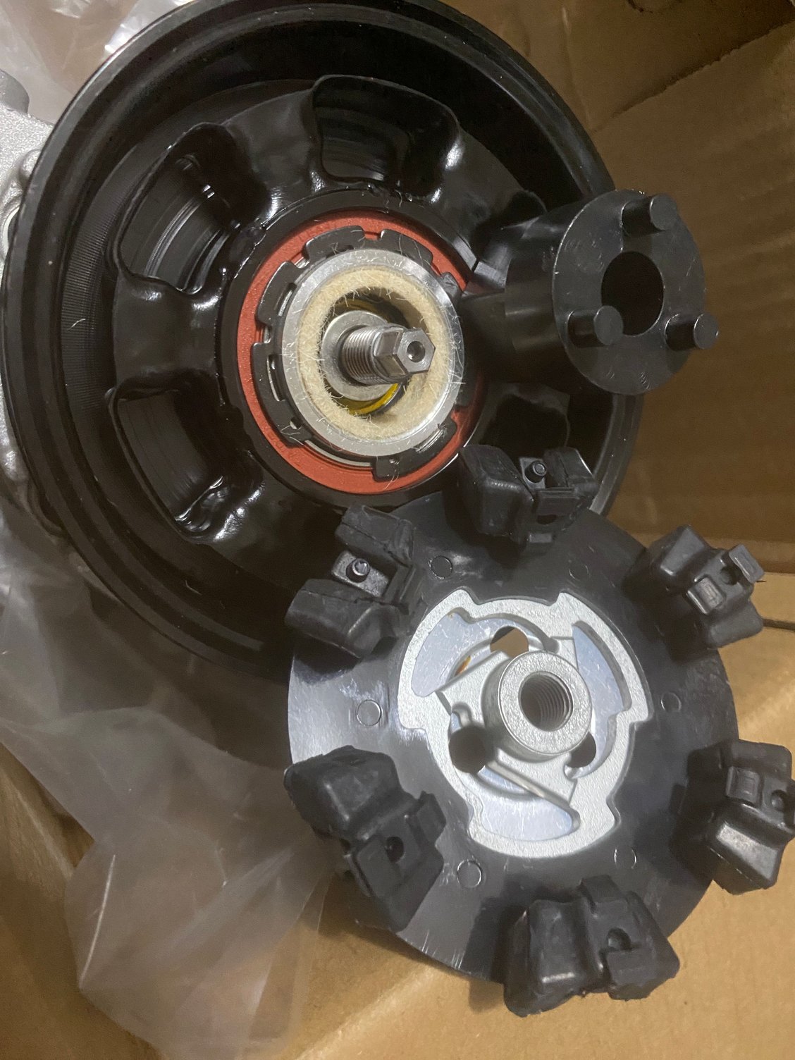

There will be no lights on dash. But there should, in theory, be a code if refrigerant is low. You may also want to check the compressor itself. You have a constant-on compressor style. Basically it is clutches and always operating. I believe 5% is "off" and as cooling demands climb the variable orfici located within the compressor itself opens up to a max of 100%. What this also means, having no clutch, is that there has to be a safety element in case the compressor itself fails. So there is a breakaway plate built in. The pic below shows a failed one, the plate is gone. Second shows the plate removed for install of a new compressor. If this is broke you have a very large project ahead of you.
