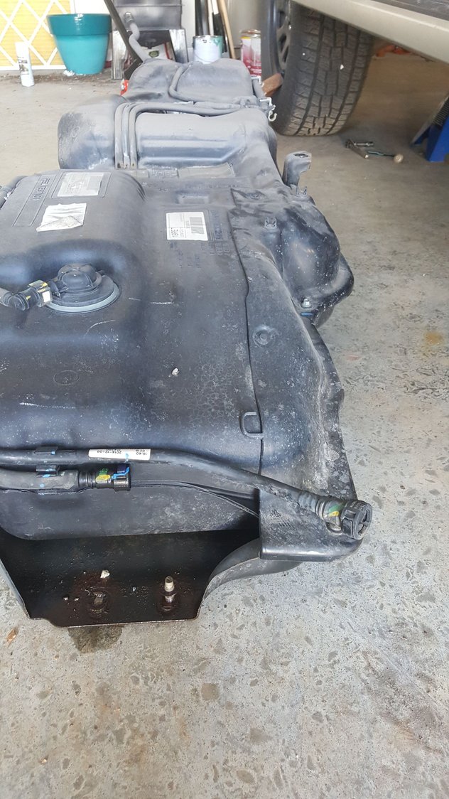

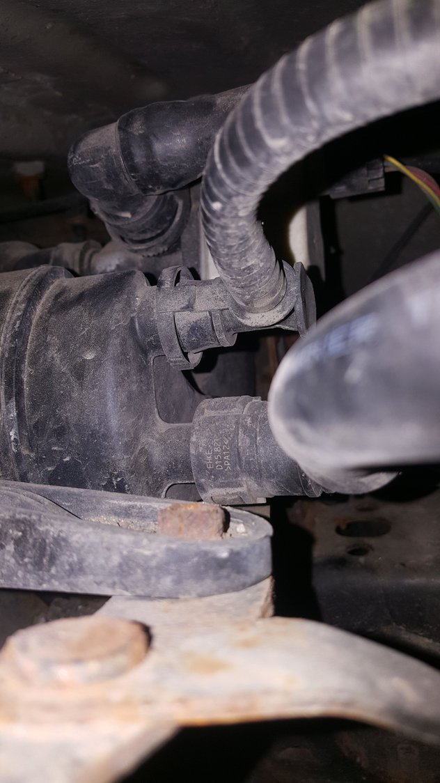

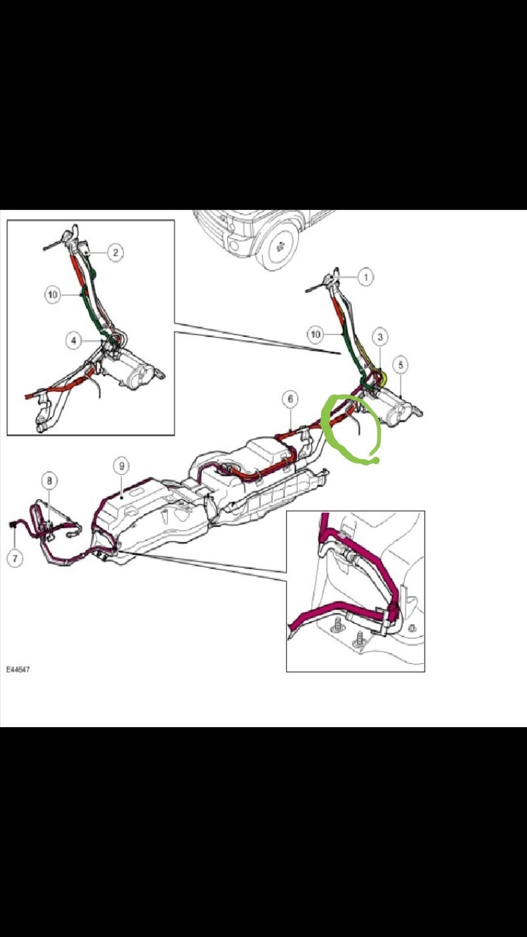

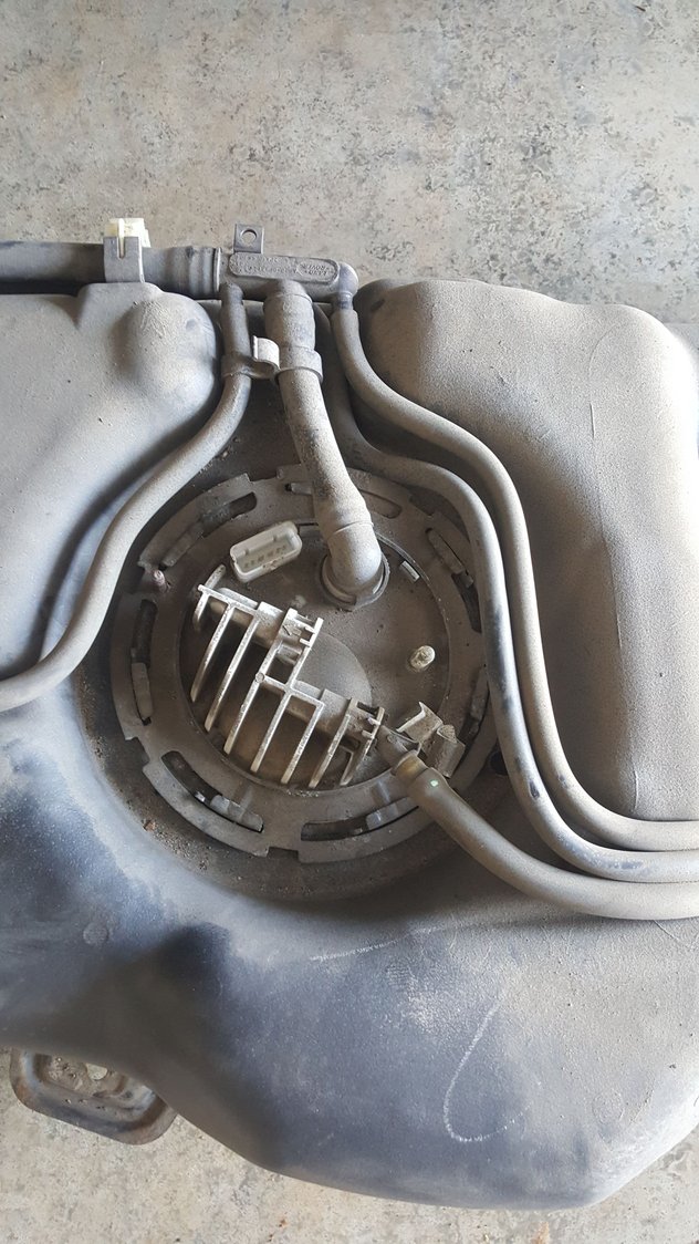

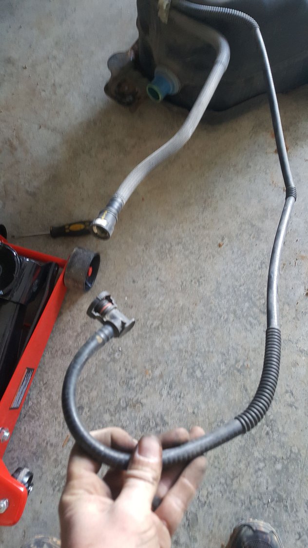

It's behind the spare, above the rear diff. Regardless, it is hard to make sense of this.
Above, I circled in green where I think the purge valve from the engine bay connects (I have never traced it).
if the noise is in both the filler neck and the engine bay purge valve, it HAS to be something with the EVAP canister / DMTL pump (4 and 5 in the diagram)
below is what the connections look like. The white piece with the electrical connector is the DMTL pump.
below are the two connections from the gas tank to the evap canister. Blue port on the tank in the background is where the filler neck connects
finally, here are the front fuel feed lines on the front of the tank.
as you can see, the fuel purge valve in the engine bay does not connect to the tank.
I think the next step is checking the connections and function of the evap canister components.

Looking at the blow up of the filler neck, there are three lines: red, green, and yellow. Red terminates at the fuel filter on the top of the tank (large connection to the right of the electrical connection below)
That breather, underneath the fuel filter, connects to another line. I'm assuming to allow contraction and expansion of gas in the tank and equalize appropriately. I circled the nipple in green on there the in-tank line connects.
the green and yellow lines come from the evap canister. One, I assume, is the fresh air intake to purge the fuel from the evap canister. If this is clogged, that could create issues by itself. Possibly, creating vacuum that sucks the fuel through the system, from the tank.
you may want to pull the right rear wheel well splash shield and inspect those three lines as they connect to the filler neck. If I remember right, there is also an in-line air/fluid separator, designated as #2 In the earlier diagram.
