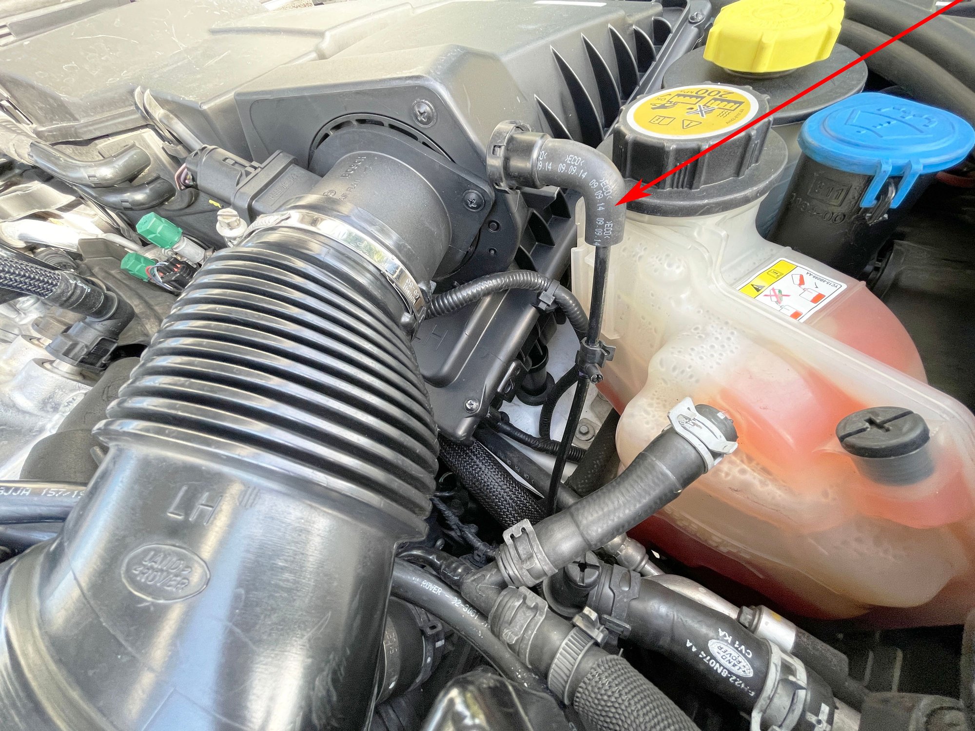

Also any idea what this part is? I noticed it sitting there after the main dealer replaced the radiator 6 months ago. Has a hose attachment on it which is not connected to anything. I removed the end cap and there is a white shiny foam membrane sealed at the end under the cap.

I believe that part you reference is the breather for the front diff. Mine is tucked in closer to the radiator.
