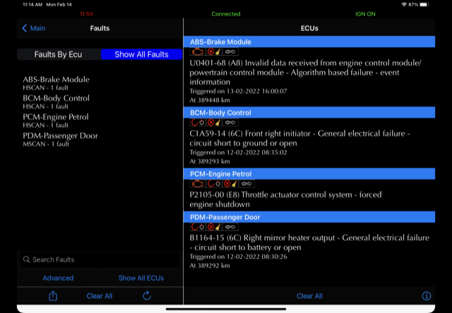

I am having issues with my 2011 LR4 and hoping someone can offer some incite or has had similar issues.
It will randomly start running very rough while driving, causing restricted performance and limp mode. When you pull over and turn the ignition off and on, it runs fine and you can continue until it happens again.
Previously it was running very rough 100% of the time so I replaced the throttle body and I thought I fixed the issue but now I'm stuck with this intermittent problem.
The following are the codes from the GAP tool.
Could it be a bad ground?

Your faults my not be real.
For the first
U0401-68 Invalid Data
Received from
ECM/PCM A - Event
information
Invalid data received Check the engine control module for related DTCs and refer
to the relevant DTC index
and the next
P2105 Electric throttle malfunction indicator lamp (MIL) request duel fuel cut off
The C fault might be real though and I fail to see why the miro heater is an issue. I would check the C open circuit or short circuit. The initiators are located at the front of the front wheel arches and at the rear of the rear wheel arches and are secured
with two scrivets. The TPMS has four initiators and each has a connector which connects with the body harness. I fail to see what importance they have to actual driving and have no relevance to limp mode INMNSHO

Yeah the TPMS system seams to be operating properly but I will check.
Do you know where the grounding point is for the TPMS?

Can't find it yet but check the fuses in the EJB since they go vai that and the message is typical for a bust fuse

The only error codes it throws are for the throttle sensor. I think that is from the drop in voltage.

I thnk the throttle DTC is a red herring. None of the original DTCs have come back so it is just a glitch and if you read the workshop manual you soon find out how the assignment of DTCs seems a bit random.
