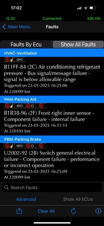

I have a 2010 LR4 with the parking brake icon flashing continuously (red) and U2002-92 (2B) code on when scanned with Gap tool.
The only thing I've done so far is replace the EPB switch which has had no effect
My questions are as follows
1. Does anyone know if there's a reset that needs to be done? I tried to clear codes but it either doesn't clear or comes right back.

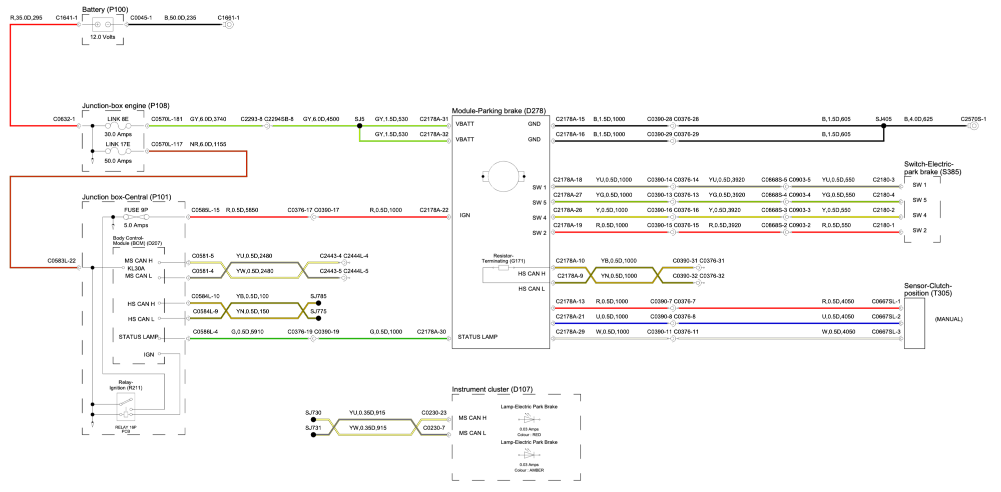

2. I'm thinking the next logical step would be to trace the 4 wires that come off the switch to the Parking Brake Module
3. Is the Parking Brake Module on the wiring diagram the Parking brake actuator (LR072318) or something else?

I suppose you could be right in assuming the switch was the culprit... but further investigative measures were clearly needed.
One of the reasons for throwing that particular code is also the typical reason... slow activation of the parking brake.
Out of interest, was the engine running when you attempted to activate the epb?
Slow activation has roots in insufficient voltage, insufficient current or contaminated parking brake lines.
So, for giggles. (and as it is in fact the fist pinpoint test) With the engine not running, with the battery not connected to a charger, with the battery sitting not under load for 6 hours, what is the voltage reading?
Also, what other codes have been thrown?
Cheers.

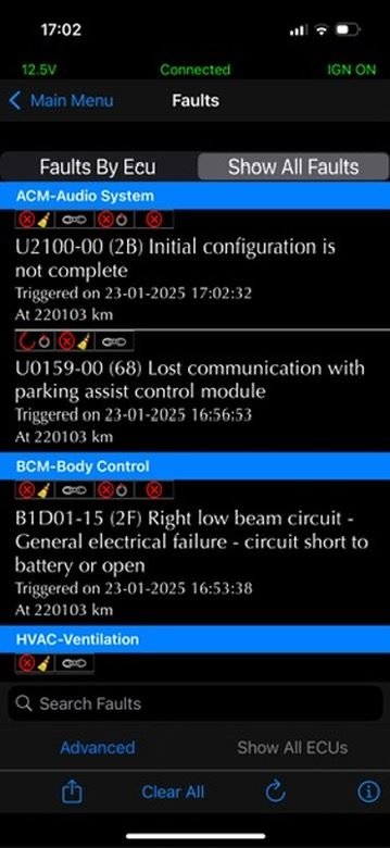

I just rescanned the codes after driving a while (since I did a reset yesterday trying to clear the EPB code) and have the following, I didn't see/notice the ACM communication lost code before but it seems that may be related?

As the voltage seems sufficient and as per the workshop manual, could we start with a system reset (disconnect both battery leads from the battery...)
Reconnect then read the codes again?

The module itself is certainly a possibility, do you know if the module at the rear of the car (near the spare tire) is the one referenced in the circuit diagram? If so it seems possible to test for resistance in the harness/connectors before blindly replacing
