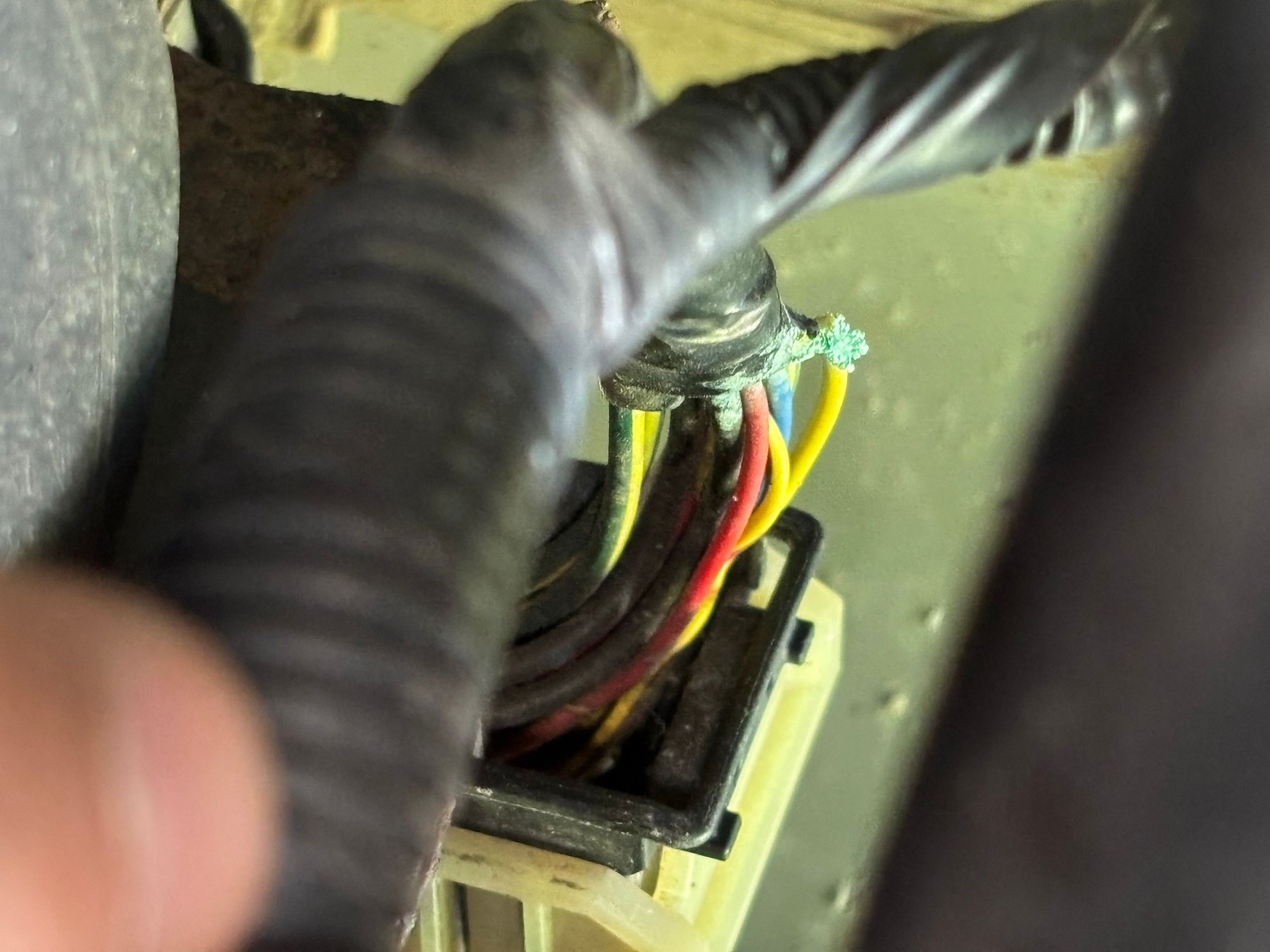

Updating in case this comes up for someone in the future, I found a broken wire near the plug into the EPB module (rear center/right of the car, just in front of the spare wheel)
all I had to do was clean the wire, splice in a new one and all codes cleared themselves
