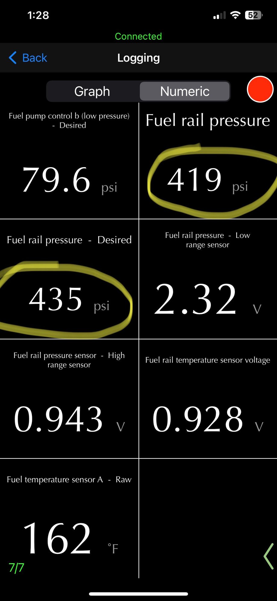

I know this is an old thread but I just wanted to add my experience with this code. I have a 2016 L494 and this code popped up about a week ago. When looking at the fuel pressures on the GAP tool, nothing seems way off but I can’t tell what the actual fuel pressure is at the fuel pump at the tank. I have a replacement low pressure sensor but I’m thinking of doing the software update first. I’ll post back my findings.

Keep us posted. I had the same and pissed me off for months. I tried the software update, twice, and replaced the sensor. I got conflicting information from the dealer and my indy and I was reluctant to pull the fuel tank down and replace the pump unless I had more definitive information. In the end it was the low pressure pump in the tank. Both the dealer and my indy said if it was the pump "the car wouldn't start". But it worked fine. It was off just enough to throw a code. The software updates seemed like they worked as I was driving home but a day or two late it would kick back on. I think the software update increases the tolerance before it throws a code.
The dealer wanted a $1k+ to replace the pump when they did the fuel gasket recall, which is crazy since it's literally 10 mins extra when the tank is down. I ended up doing it myself for $150. Its not a hard job if you have jack stands or ramps....but Its a **** job. You have to dig you hand into a fuel tank, which is sketchy. I think I made a writeup on it but if not, I can send you details of how to do it if you get to that point.
