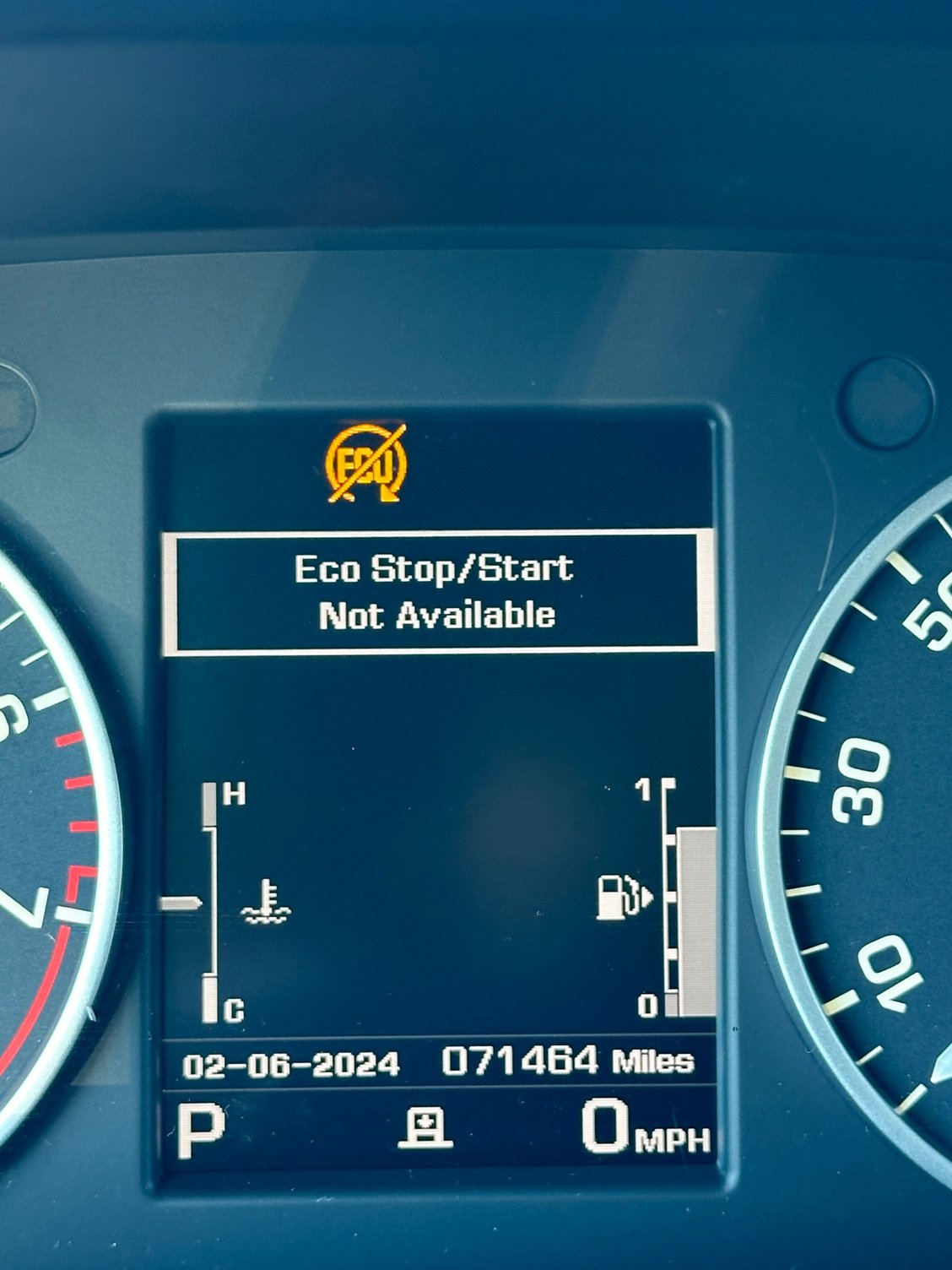

I had this same code of DTC P0089-64 'fuel pressure regulator performance'. My indy got me this far to obtain the fault but said since it was a PCM software fix, I had to go to the dealer. The dealer charged me $220 for an hours labor even though the service bulletin put out by Land Rover say's it's a .2 hour fix.
Once reset and I left the dealer, I literally restarted the car twice and now the ECO stop/start light is on and will not come off.
Reading through the service bulletin, I see the following language - "Connect the Jaguar Land Rover-approved battery power supply to the vehicle startup battery."
This makes me think the ECO start/start disable not being avaialbe is related to how they serviced/reset the light. Any thoughts on this from the LR hive?

I had a similar thing. The issue was my eco battery was dead but for some reason the check engine light never came on. After I did the PCM update it must have reset the system and the eco light came as I started the car to leave the shop. They tested and found the battery was in fact dead. And after thinking about I did not remember my eco mode turning on for a couple weeks prior. Seems like a weird bug in the system and those batteries do go dead. They put in a new one and light was gone.

Wow. I updated mine at home with the GAP Tool. I just used a trickle charger to charge the car overnight to full charge before updating. It only took a few minutes but the process is scary with the weird light sequence. My car (RRS) doesn't have a 2nd battery for auto stop/start, just a main battery. No issues after update and it's been good for the past month.

Eco stop-start relies on main battery and monitoring (aux) battery charge thresholds being met.
Many inde shops do not follow what is clearly written in the workshop manual…. before commencing work attach a high current battery charger.
In your situation, one or both batteries are not sufficiently charged… or can’t be charged as they have deteriorated to a point where they cannot maintain 80% of peak (measured at 12.6v)
cheers
