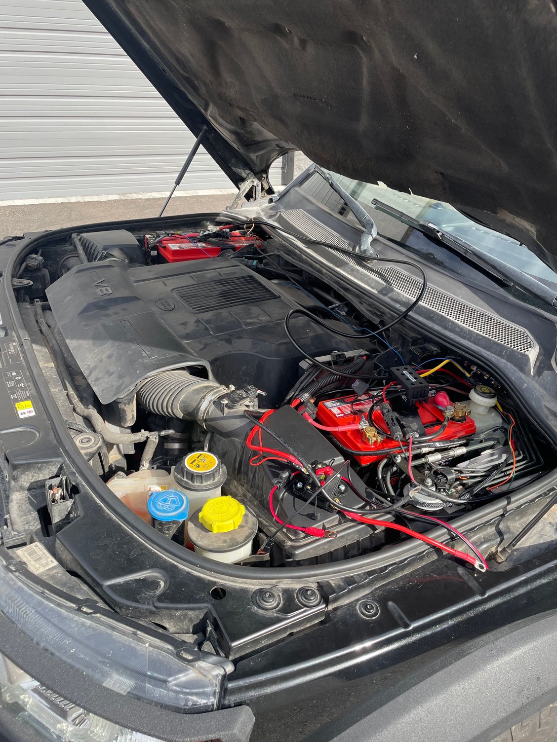

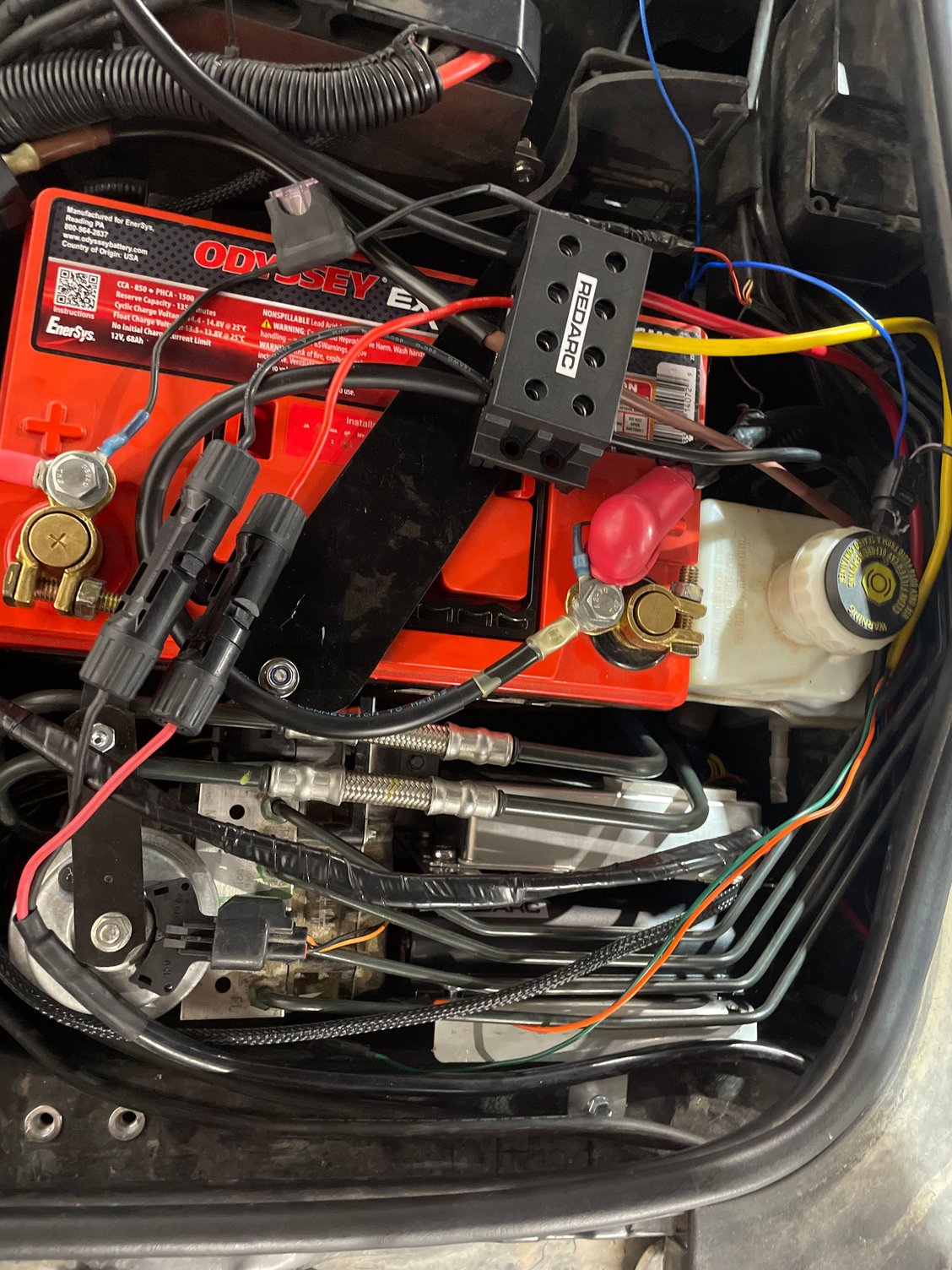

I’m installing a Redarc BCDC charger to charge my dual AGM battery setup properly. Simply tying the batteries together with a solenoid doesn’t give these oversized AGM batteries the juice they need from the smart alternator (been there done that) so I’m trying something new. So far it seems to be working as advertised. However, I currently have the power signal (blue) wire from the BCDC tapped in with an add-a-fuse to the ignition circuit (position 5 or 6 in the under hood fuse block, I forget which one). Even that circuit seems to go hot when I so much as open a door. The problem with that is the bcdc is pulling 25 amps from the starting battery every time we open a door and all the random circuits that draw power go hot, which is less than ideal if that happens all day long at a camp site in the middle of nowhere.
Anybody know of a circuit I can tap that is only hot with the ignition on, preferably under the hood? I’m fine with doing a wire tap, the add-a-fuse is just nice for the convenience aspect but I’ll use whatever is available at this point.
Thank you.
btw I know people like pictures so here are a few of the rig and current “op check” wiring which is not finalized, still need to clean everything up.
