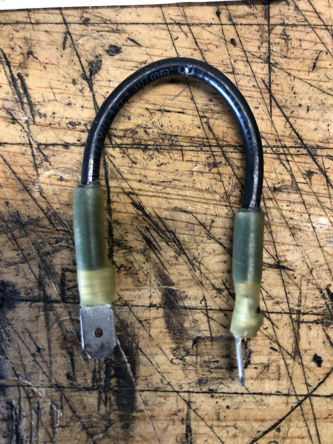

You can identify what really powers those and remove the relay and jump the circuit with a thick gauge wire with 2 male tabs attached to it.
Old Oct 15, 2019 | 06:04 PM
abran's Avatar
Posts: 6,915
Likes: 793
From: Huntington Beach CA
Like this:
