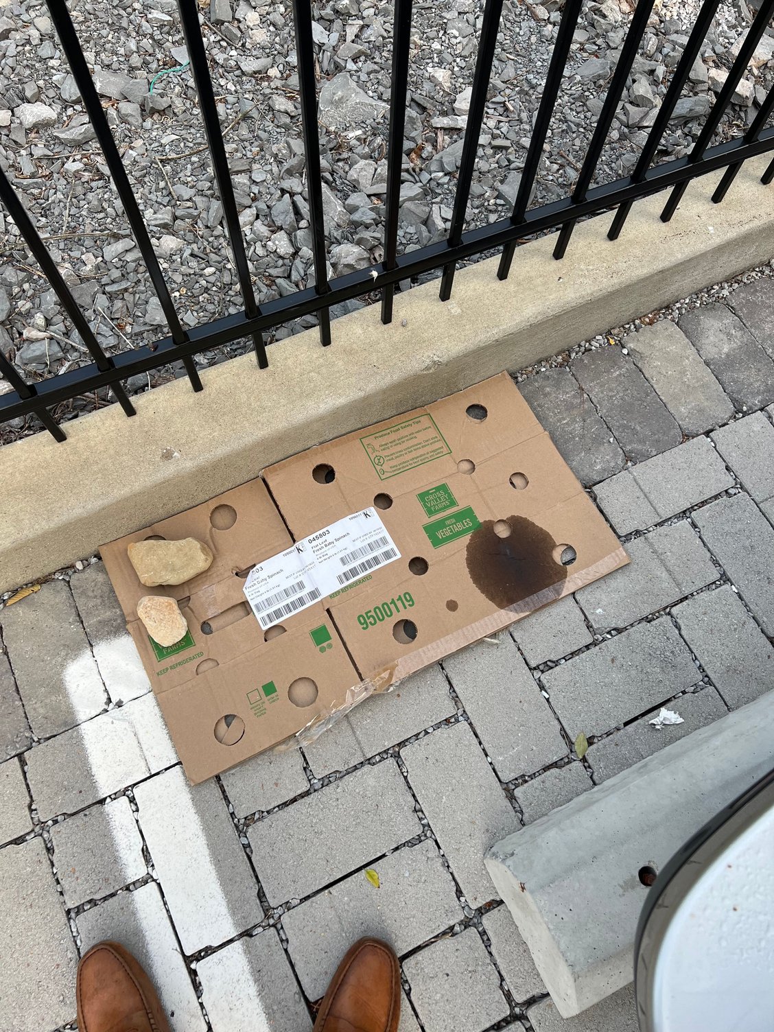

So I purchased my first Land Rover last week and it’s already at the shop lol. Went to take it to get a fresh oil change and they noticed an oil pan gasket leak and a small coolant leak they couldn’t identify in the time they had it. (Said they would need to put it under pressure in order to locate it). I stuck a piece of cardboard under the engine overnight and this is the amount of oil it’s leaking.
They quoted me $1600 to replace the gasket. It’s a $30 part so wondering if anyone has replaced one on their own and if anyone has any advice on the coolant situation.

Do you see what’s involved to replace the gasket? Have a look underneath.
Seems expensive but not outlandish to me.

I’d go with replacing with. Mine had oil drip into the alternator which eventually killed it ahead of its time. 3k to change alternate and the oil gasket
