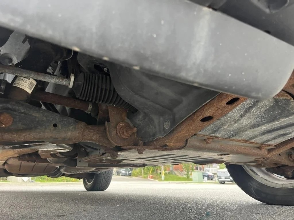

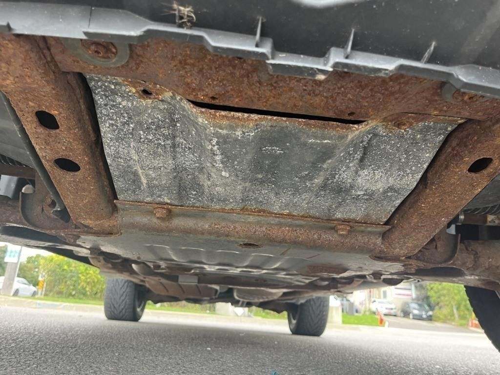

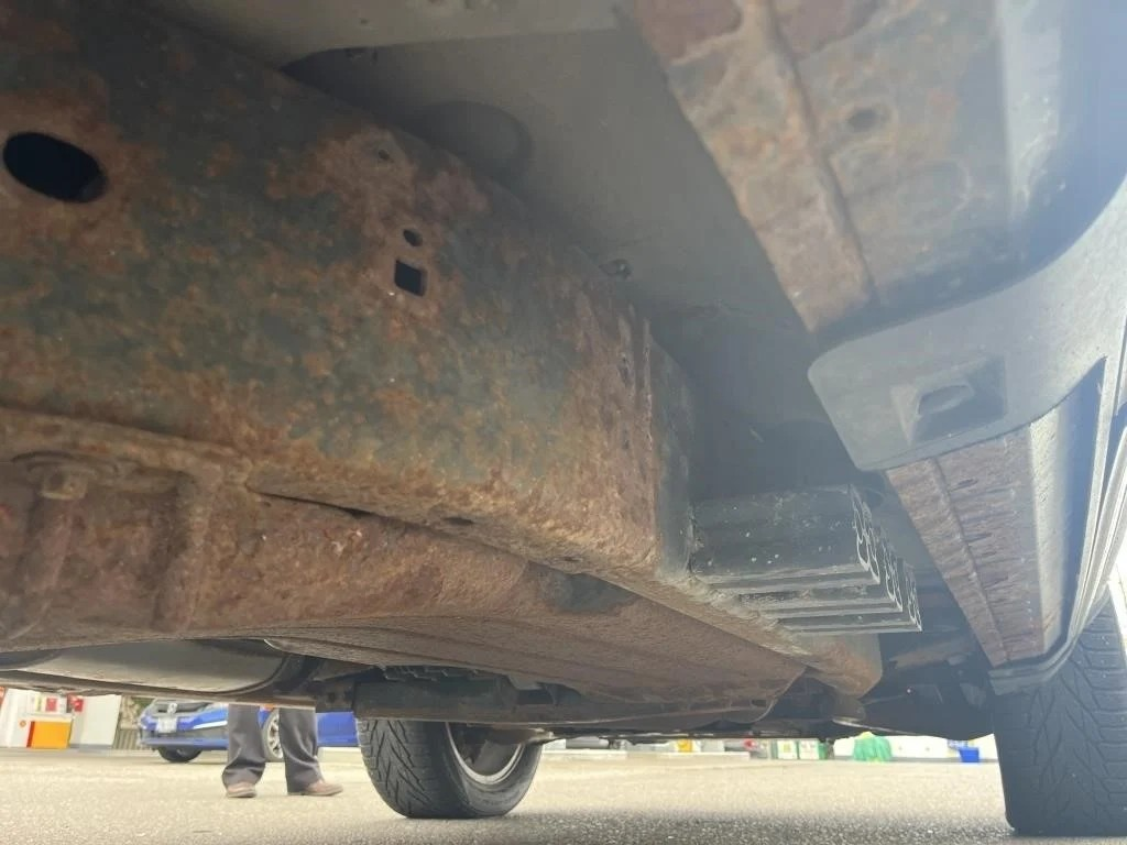

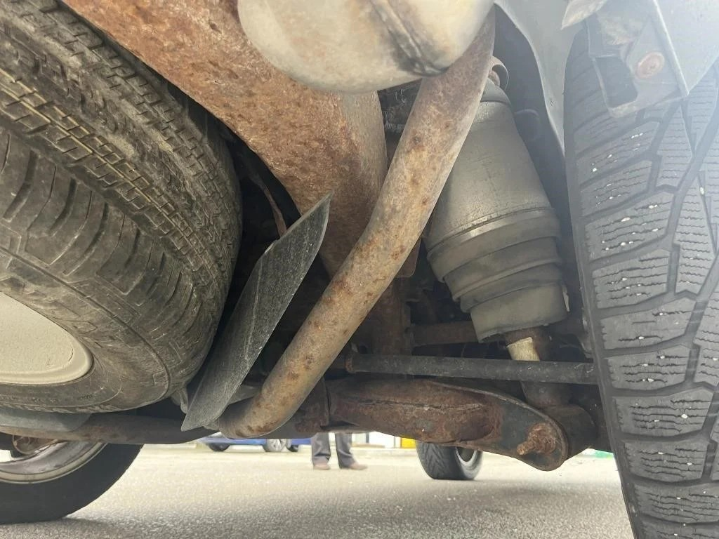

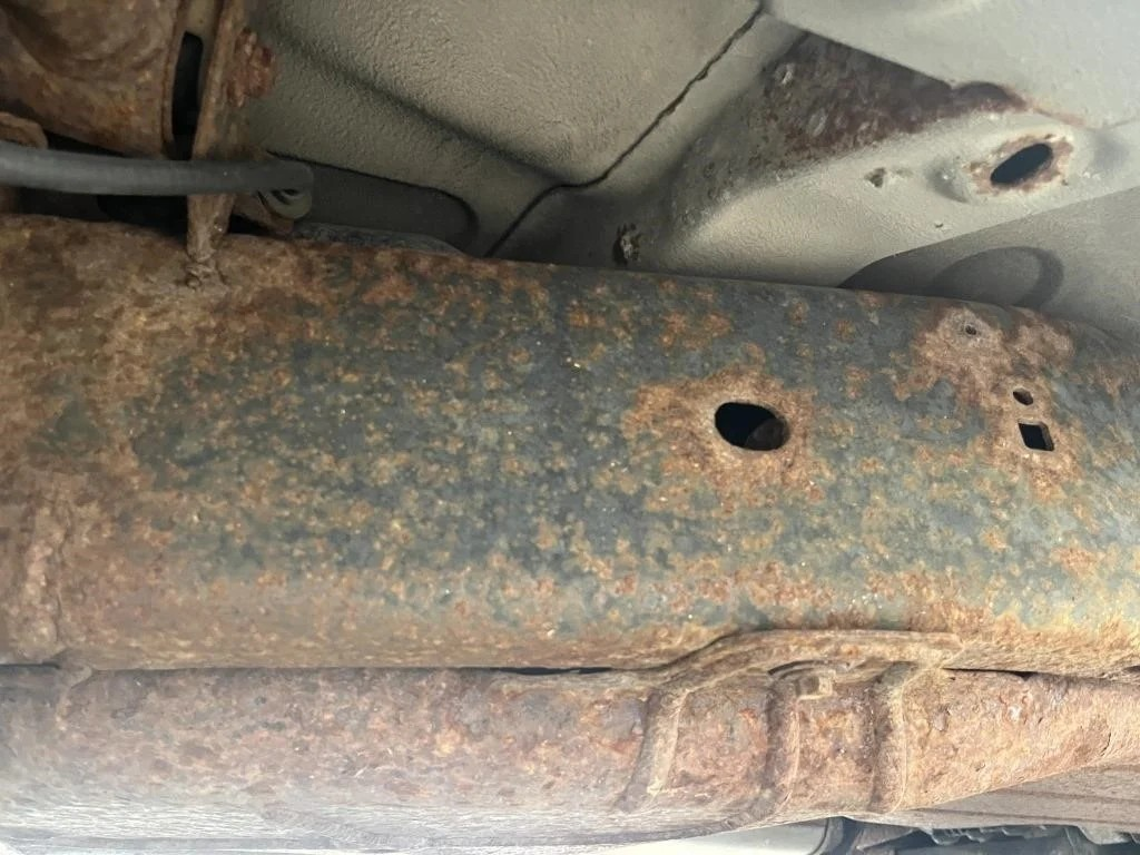

I am looking at a LR4 2015 200000 KM to be a local run around for a couple of years ( will replace my 2006 LR3 that is on last legs)
I have attached some pics of the LR4 and hope somebody can advise regarding the rust. I have seen other posts that state it really depends where the rust is.

Well, clearly the rust inhibitor was never re-applied. And it should have been.
But it looks like surface rust. Therefore go get an annual spray of a lanolin based product. I use CorrosionFree.com product.
Be sure it passes the safety. With it looking like that, I’d check the rear brake lines too.

Thanks for your thoughts Guy, I think I'll factor those costs in and offer lower to budget accordingly.
