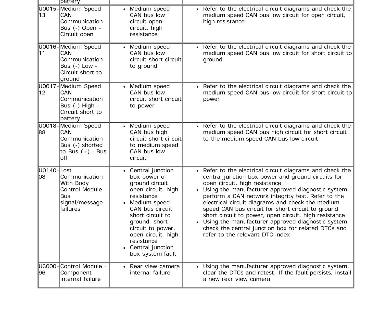

Perhaps this helps.

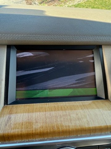

Ok, I have the STOCK CAMERA in the LR4... after going thru the "secret menu", the video I get is this... any thoughts on what it could be? At least there's life in this view!
