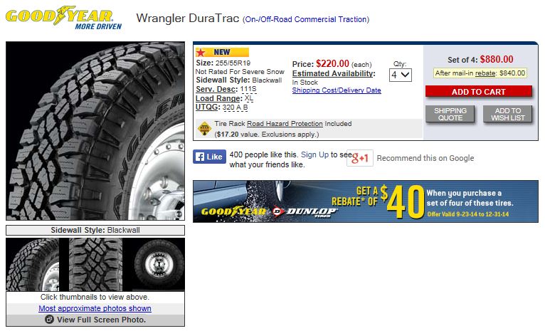

The simple answer is to source a set of 19" wheels. I run my winters (255/55-19) on a separate set of wheels. In 20" the tire choices are not bad for on-pavement. The best reason to go for 19" wheels is that Goodyear has recently started making Dura Tracs in 255/55-19 which is a no holds barded off road tire. A great development.
I guess I need three sets of wheels....

Originally Posted by Jagfixer
DuraTrac??
Yup. Good Year DuraTrac. 255/55-19
http://www.tirerack.com/tires/tires....omCompare1=yes

Yes I did notice the DuraTrack offering in 255/55/19. I noted though that this is classified as a commercial off-road tire. Has anyone tried them? I'd have some concern that they would be like the previously mentioned "wooden clogs" for the 90+% of time spent on paved roads. Also for some reason, all sizes EXCEPT the 255/55/19 are classified as snow rate.
I notice that in the 255/60/19 size Goodyear offers the "Wrangler All-Terrain Adventure with Kevlar®". Seems like it could be a more pliable tire and has a much larger wear rating (640 vs. 320) that the DuraTrac. Anybody have experience with this tire or even this size on the stock rims?

We picked up an 08 RR that had BRAND NEW Dueller Alenza Plus tires on it and my wife HATED them. I though they were "ok", they did not ride like a washboard on her RR, but they are poor in wet/snow/higher speed.
We considered the Wrangler Adventure, but it seemed a bit too much like an old 80's tire cosmetically for my wife. We ended up putting a set of Duratracs on the RR and love them. I had all the same questions as you (commercial?, no snowflake, only one made in Germany, etc).
I asked around on the Expedition Portal site and many people have them on their LR3/4 and RR's in Europe.
These are relatively new in the US in this size. I sent a message to Goodyear asking why this size is different and they only said that the specs are different because this size was developed specifically as a Land Rover OEM tire, I presume in other countries unless it is going to be part of some of the upcoming new Defenders or something.
Anyway, my wife wanted these and loves them. There is some noise at highway speeds, but minimal and certainly not offensive. Of course it all depends on what you want. I think the Michellins are the ideal choice for the other side of the spectrum - those who want the premium ride, lowest noise, and some grip.
If you want extra traction, stronger construction and durability (not wear, but abuse strength), and great beefy looks, the DuraTracs are the ideal choice. Here are some pics
