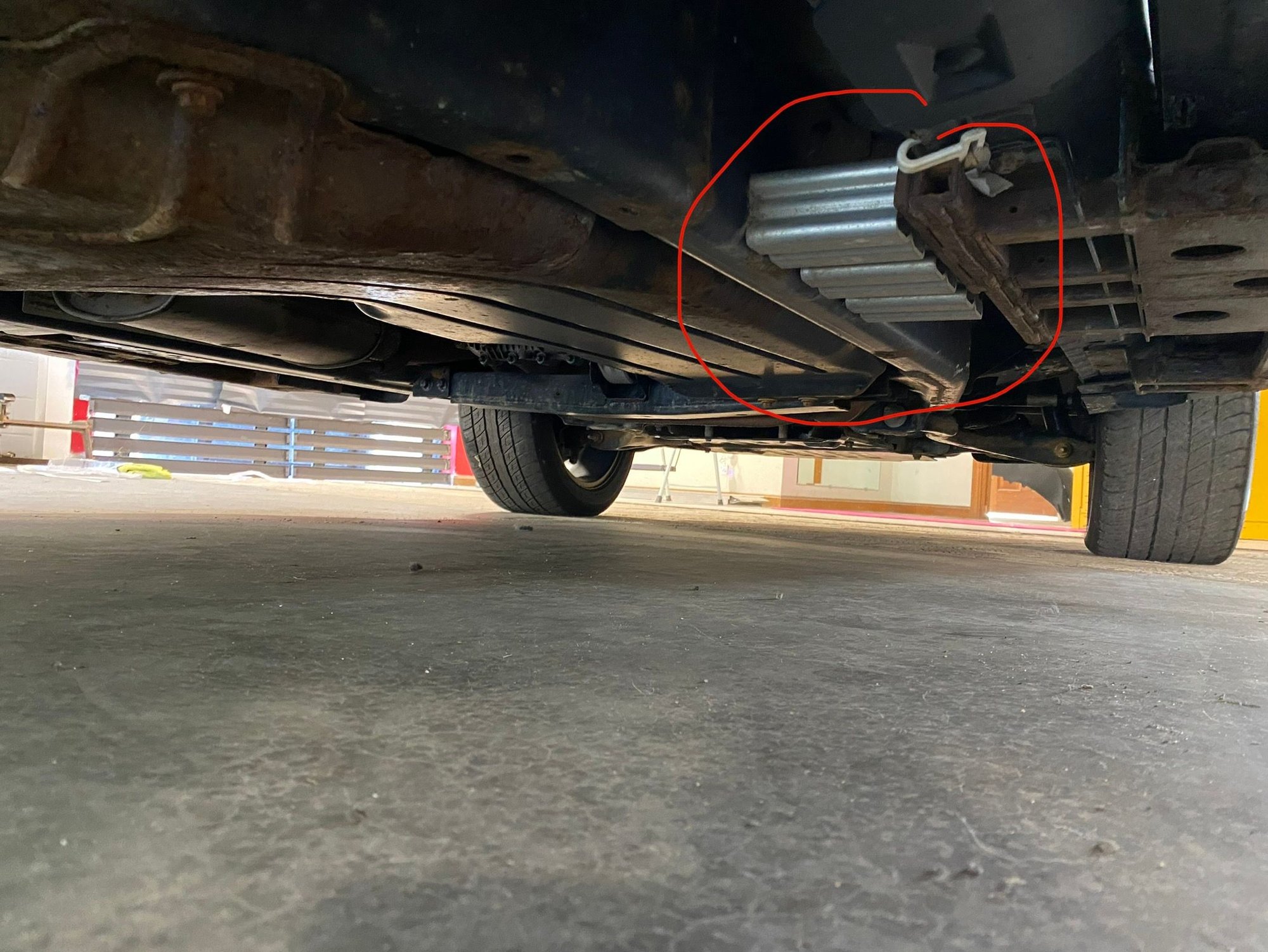

I’m looking at buying an LR4 to replace my ‘98 Discovery. I noticed something on the under carrot that I haven’t seen before.
Can anyone tell me what I have circled in the attached pic is and what that white hook is?

Well what is all that hardware further right? Running boards?

Good question. I was focused on what stuck out like a sore thumb. It does have running boards on it (see pic). I’d thought they were the stock ones. That hardware looks more extensive than what I’d expect for the stock running boards though.

Which leads to my biggest complaint; there is all kinds of interesting technology integrated into these vehicles. And unlike Jaguar, very little factory issued documentation available describing the technology. Another example, the two hunks of swinging cast iron behind the rear wheels.

The running board hardware is much more extensive in the LR4 2014-2016 vs the LR3. I don't know what the hardware is like in the LR4 2010-2013.
My LR4 has the same "aluminum tubes" that were exposed after I removed the running boards. My guess is they are for extra support from a side impact.
The hook may have been left from when the vehicle came over by ship. I've heard they strap them down while in transport.
As for the weights in the rear, they help to reduce vibration in the frame for a smoother ride.

white hook is a red herring. The aluminimum bits are spacers or whatever. Best thing to do with those running boards is to remove and sell on ebay. They will lead to rusted out sills. Worthless POS. Yes, the weights at the rear are harmonic dampeners.
The LR4 manual is available for download - for what it's worth. It's not great and it assumes a lot of pre-existing knowledge and availability of specialist tools.
Looks like a nice vehicle. Check the mileage and check the coolant crossover pipes (front and rear) have been done or do them once you take possession. It's a real issue. Lots of work but a doable DIY if you're feeling brave. Excellent 'how to' guide on YT by a fellow member. Good luck.

As for the weights, this is exactly what they are for:
