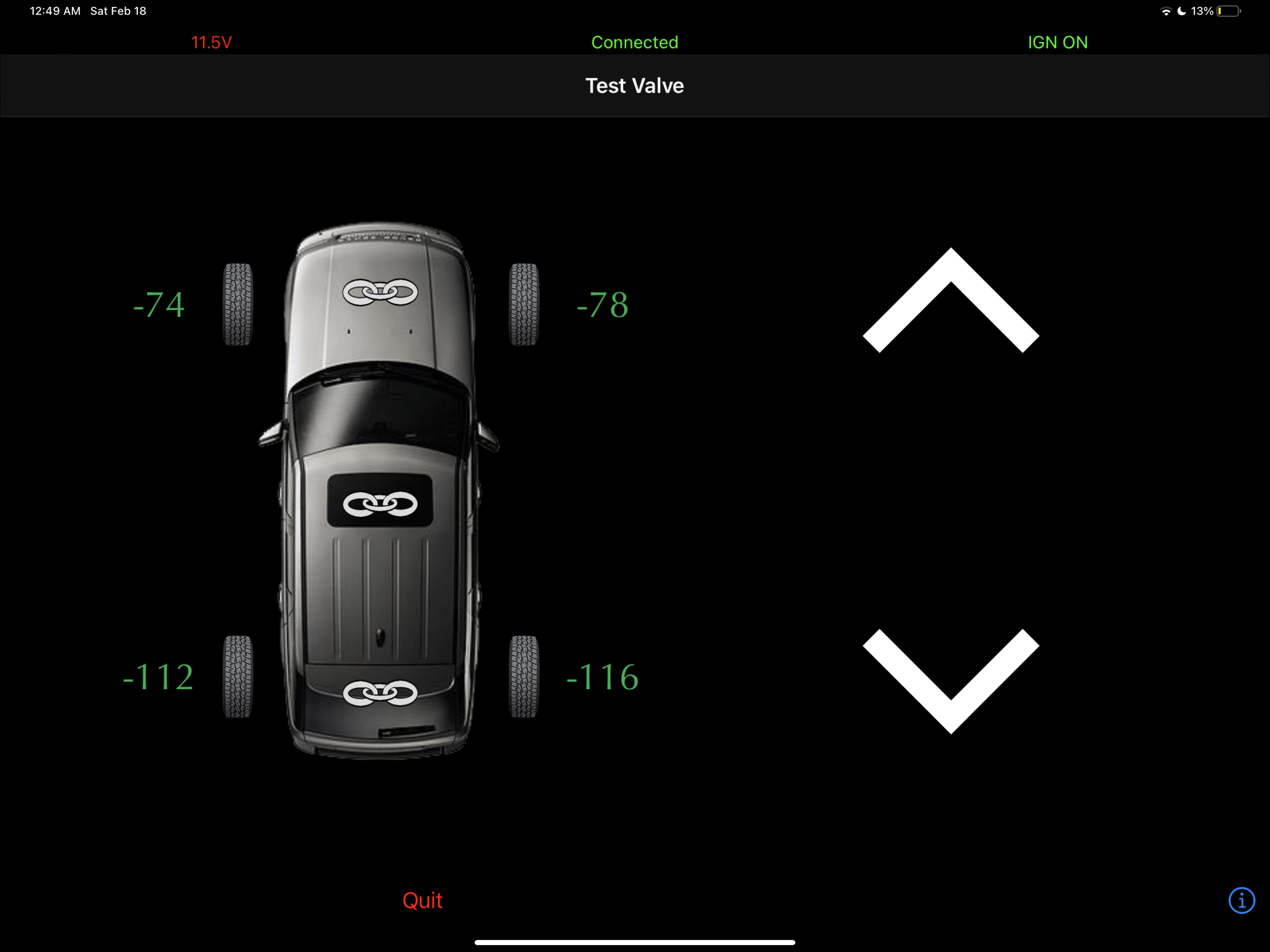

Second, the vehicles suspension is all the way deflated and I cannot raise it. I want to see if the vehicle can even do so. I have a gap lld tool and I try to adjust it from there but nothing. I selected height control and it just says suspension fault on the dash. Then I go to test valves and nothing happens. I cannot start the car, but the battery is fully charged and hooked up to a charger to keep it charged. Update: the fuse was busted. Was able to raise it, will see if it deflates overnight and what not.
these are the faults im getting:L319 - LR4 2010
Vehicle scanned on 21-02-2023 20:14
Using IIDTool BT V3.0 B2643
ABS-Brake Module
  • U0421-68 (28) Invalid data received from ride level control module - Algorithm based failure - event information
    ( on 21-02-2023 20:08:18 at 254155 km )
DDM-Driver Door
  • B109C-15 (2F) Front courtesy lamps - General electrical failure - circuit short to battery or open
    ( on 18-02-2023 01:02:44 at 254155 km )
  • B110A-11 (6C) Rear door driver side central locking motor - General electrical failure - circuit short to ground
    ( on 18-02-2023 01:01:53 at 254155 km )
IPC-Instrument Pack
  • B1A85-96 (2C) Ambient light sensor circuit - Component failure - internal failure
    ( at 254155 km )
PDM-Passenger Door
  • B110B-11 (6C) Rear door passenger side central locking motor - General electrical failure - circuit short to ground
RLM-Suspension
  • C1A30-64 (AF) Both switches pressed at the same time - Algorithm based failure - signal plausibility failure
    ( on 18-02-2023 00:50:11 at 254155 km )
    Update: code cleared
TCM-Transmission 6spd
  • U0401-64 (2F) Invalid data received from engine control module/powertrain control module - Algorithm based failure - signal plausibility failure
    ( on 18-02-2023 00:47:53 at 254155 km )
