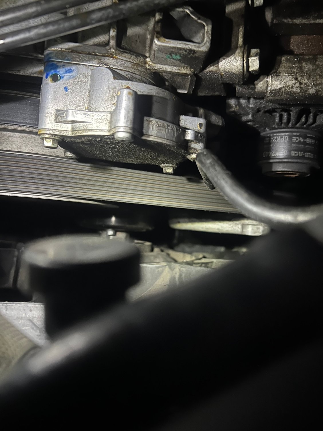

Hello all, as I previously mentioned, I have an LR4 and I do not live near a Land Rover deal or a mechanic that works on European vehicles. Therefore, I either look online to Land Rover for parts or I Google to identify parts to make repairs. Thus far, I have been fairly successful in my repairs. Two days ago, I noticed a leak underneath my LR4 and identified the location, but I am unaware of the specific part. I was able to look underneath the vehicle and take a picture of the part. I am curious what the part is AND if I can simply remove the portion that is leaking and install a gasket or will I need to replace the entire part. Any advice or suggestions will be appreciated.
Above the blue mark is where the coolant is leaking.

Vacuum Pump
