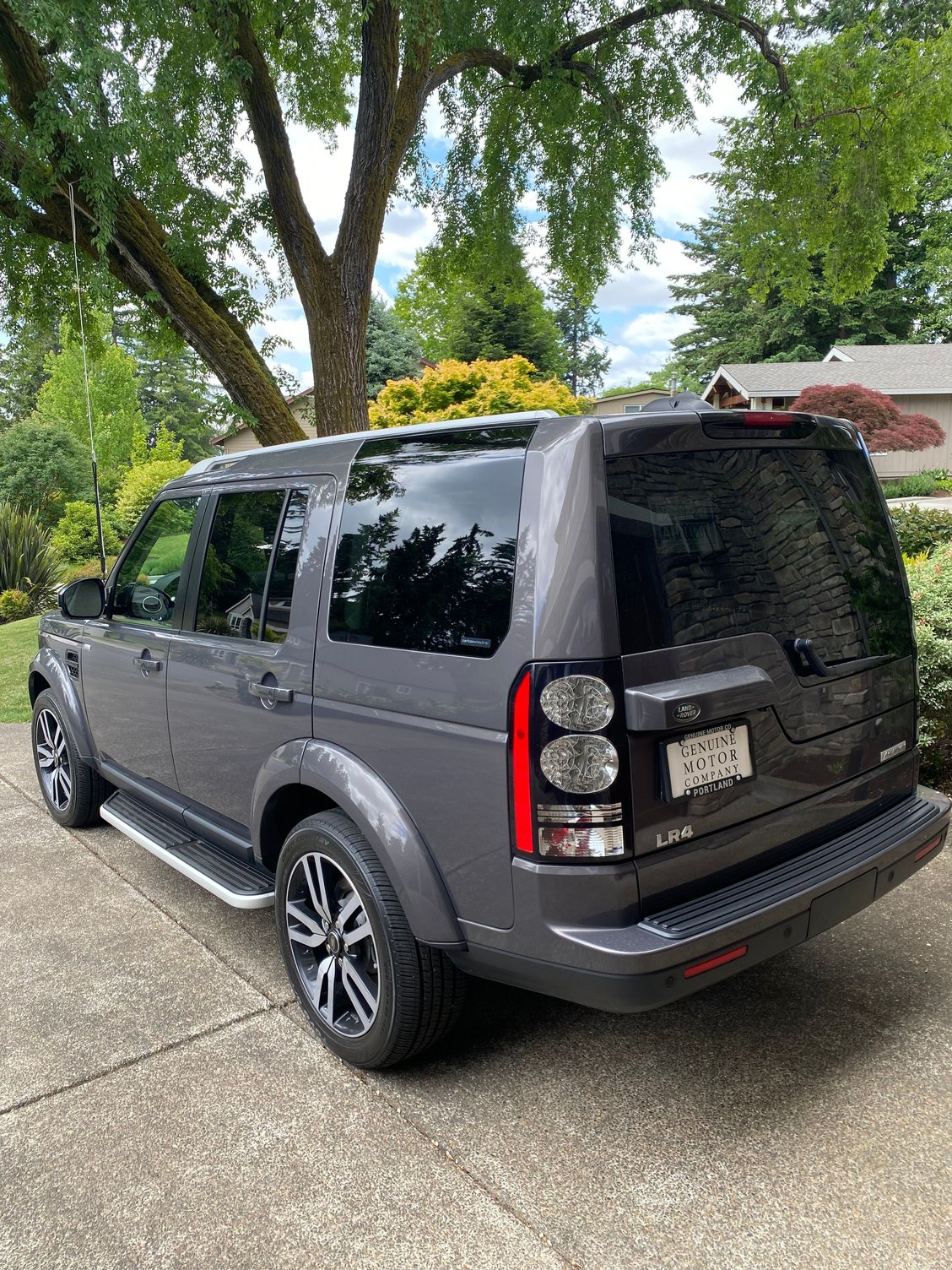

Proud owner of a new to me 2016 LR4. Thanks for all the encouragement and advice. I am taking into one of the local LR specialist shops (not the dealer) to get the initial work done but I am also going to start turning a spanner myself (I need a new hobby). Next up…any recommendations for roof racks or platforms that fit to the factory rails?

Nice…I have exactly the same car - Landmark, same color (except that I’ve now switched out the wheels to compos).

Love it. Great colour. Never seen it before. Looks superb.
