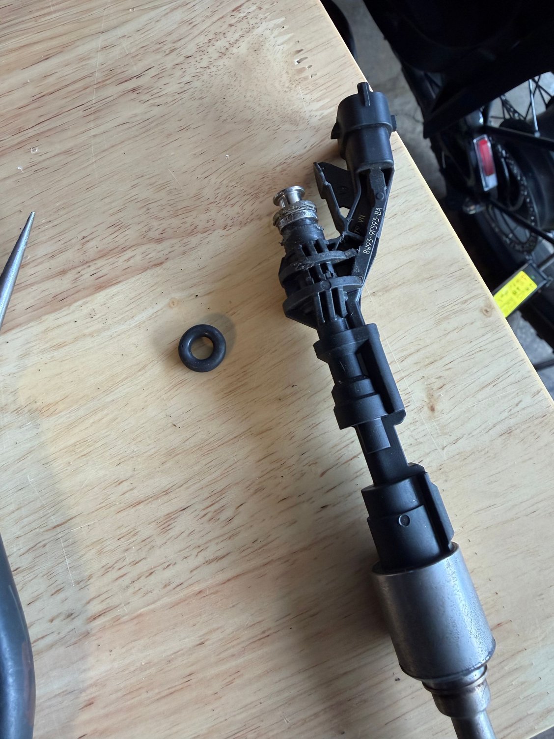

I did finally get the rear injector out. So hard clearing the brake fluid res. to line the puller tool up as you can see.
One thing that did help was actually removing the top O-ring on the Injector. This enabled the puller tool to seat on top of the injector much more easily.

Removing injector O-ring

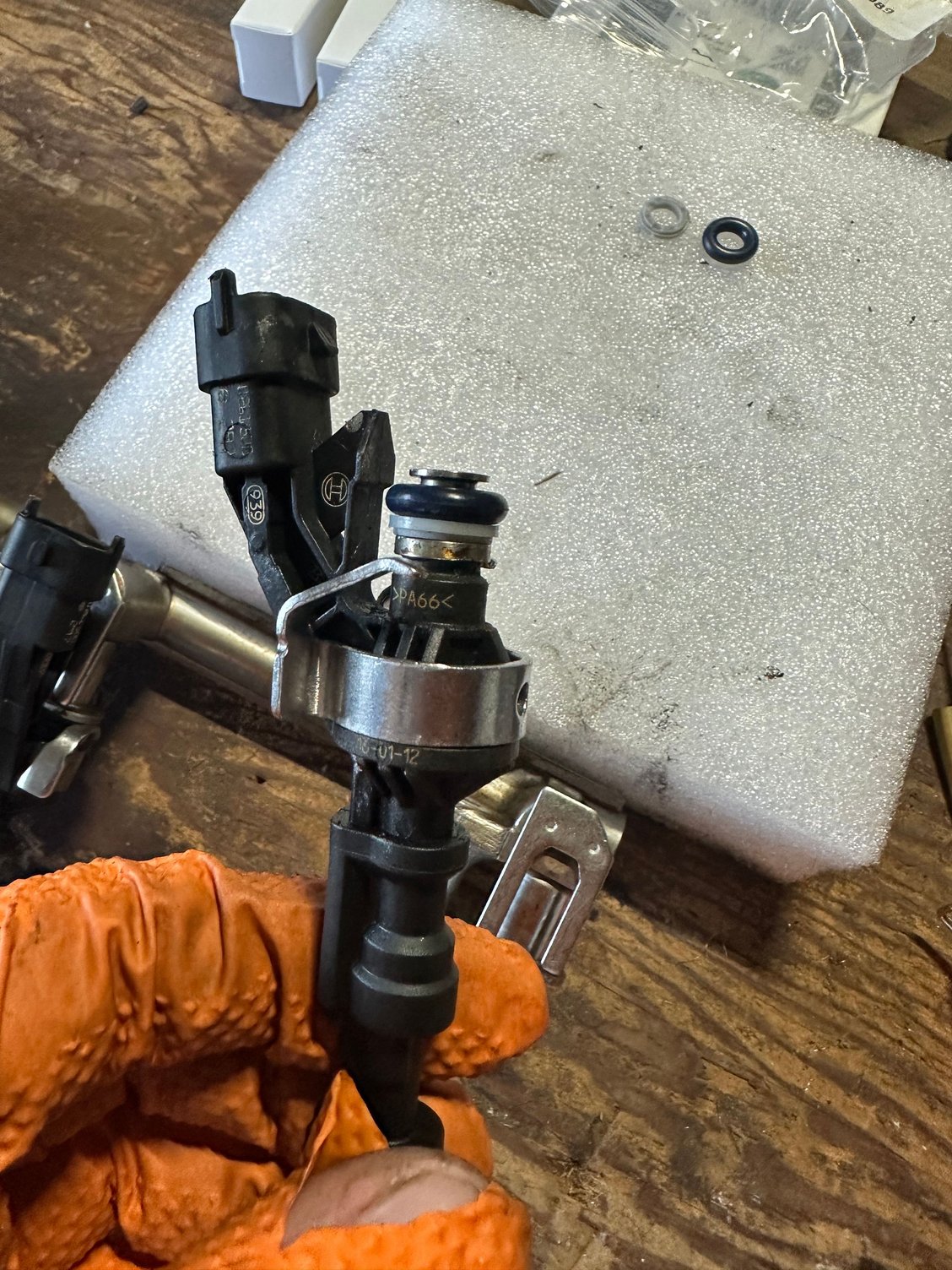

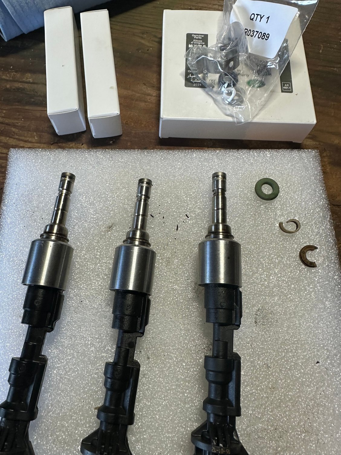

Hi - yuk that sucks. The injectors absolutely need new seals, o-rings and retaining clips before you reinstall. You cannot reuse the old ones as the teflon seals are pressure fit. Or you just need to buy new injectors. They also shouldn't have multiple 0-rings. There are 4 pieces in the injector rebuild kit:
- The white teflon seal at the tip.
- The grey rubber o-ring at the rear
- Under the 0-ring is a plastic ring thats maybe some type of spacer
- Then you have the metal retaining clip. I read these also need to be replaced as they keep tension on the rail and can cause a leak.

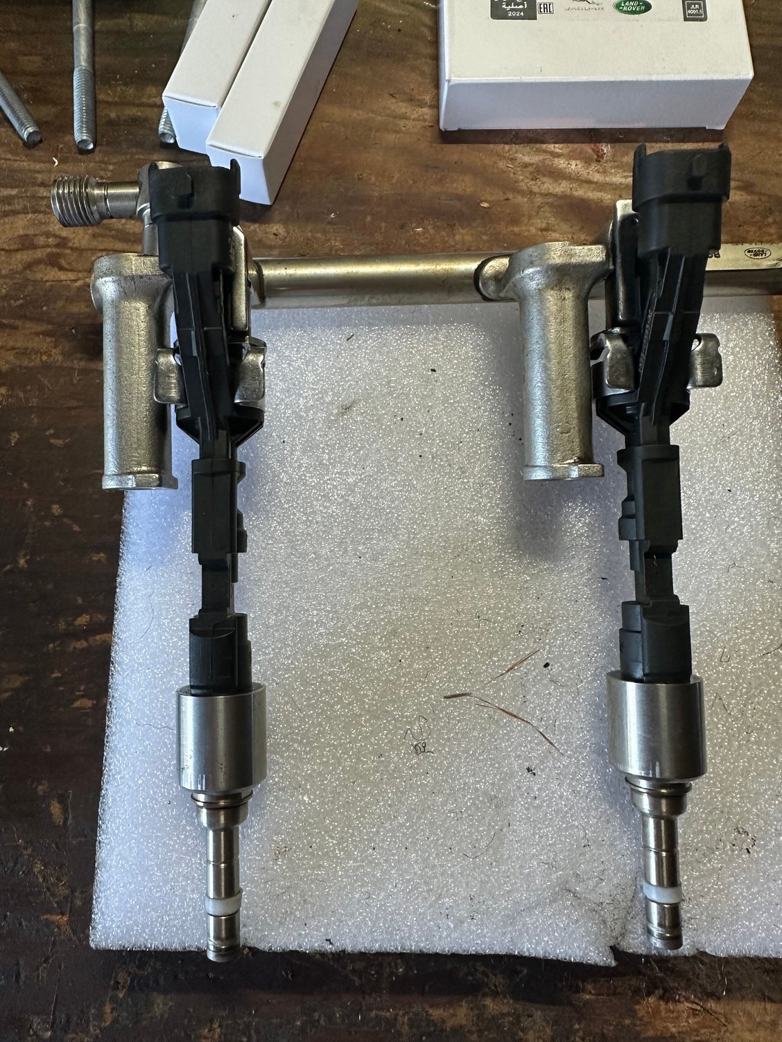

-You can reuse injectors but definitely cannot reuse any injector seals or O-Rings. That was my only real fail. Tried to be cheap and paid the cost of an extra weekend to redo the work and also another shipping charge for the seal kits.
-When adding the nylon sleeves to the injector tips, I noticed you must actually force the injector ALL the way down into the two-sided seal shaper thingy (The metal cylinder thing used to shrink the nylon back down so the injector sits snug in the head.
-I wouldn’t recommend trying to reinstall the injectors using the puller tool. It sucks for this. Instead I grabbed a 1” square wooden dowel that was sitting around, cut it to about 14”, then drove a short flat screw into one end to press against the injector face while I and hammered the other end. This helped seat the injectors really nicely into the engine and give you plenty of clearance which the puller tool does not offer.
