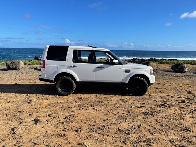

I just received my TuffAnt Steelies and bought BF Goodrich MT KM3 265/60/r18 tires, for my 2013 LR4. Does anybody have the same set up and do you have problems with tire rub against the frame of the tire well? Anyone have suggestions to resolve this issue?
One solution being suggested is to cut the small portion that rubs out of the frame and weld a plate to make it flush with the tire well. I don't like that suggestion and open to hear your comments.

2.5 johnson rod lift

I have TuffAnts (ET44) and 265/65/18 BFG KO2's on mine. No rubbing at standard heights. Are your a different offset?
