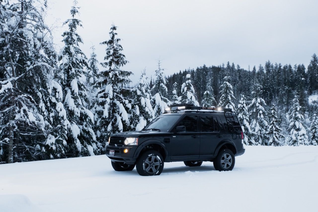

Tapping into this community for some quick thoughts.
Long story short, (2012 LR4 140k) the coolant was leaking pretty badly, the driver-side heater stopped blowing hot (Passagner is still ok), always kept it topped off, was headed out for a road trip and didn't have time to get a mechanic to look at it. Topped off the coolant and oil. Few hours into the drive after merging on to the highway temp alert came on, pulled over, temp regulated right away, saw a significant amount of coolant overflowing from resivor (no bubbles), no other visual leaks or engine noises. Had it towed to nearby Land Rover dealership - this was their diagnostic:
147314 PERFORMED CYLINDER BLOCK INSPECTION DUE TO POSSIBLE VEHICLE
OVER HEATING, AND FOUND VEHICLE HEAD GASKETS BLOWN. PERFORMED COOLANT
SYSTEM PRESSURE TEST AND FOUND COOLANT LEAKING OUT OF WATER PUMP, FRONT
OUTLET PIPE. SENT QUOTE FOR REPAIRS.
I've had a misdiagnosed blown head gasket before in my Audi. It had similar symptoms. I took it to a different mechanic, and it ended up just being the water pump!
Any chance this could be the case here, or do I need to send this rig to the junkyard? Would be disappointing, considering I've been building it out for overlanding and have become quite fond of it.
