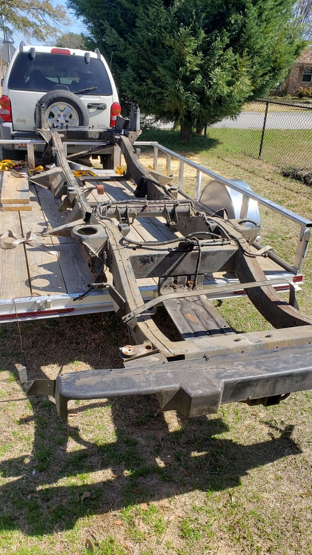

A few years ago I purchased a complete 300tdi 5 speed conversion kit. I've nearly removed the rusted out frame and plan on pulling the donor frame tomorrow. I own 5 d2s, one I've modded to a discovery pickup truck. I have already contacted the local galvanizing shop and once I've completed some mods to the frame I will deliver it. My problem is locating a company that will remap my ecu.
It's been a few days, I have now removed my old fra.e and cut it into 3rds to make it easy to dispose of. pullapart has a frame from a 2000 discovery that cost around $250, which i plan to remove Tuesday. hoping to soda last the 5 speed and 300tdi tomorrow. putting the automatic on eBay for around $350.

Brought my donor frame home from pullapart today, took about 10 hours to pull.
