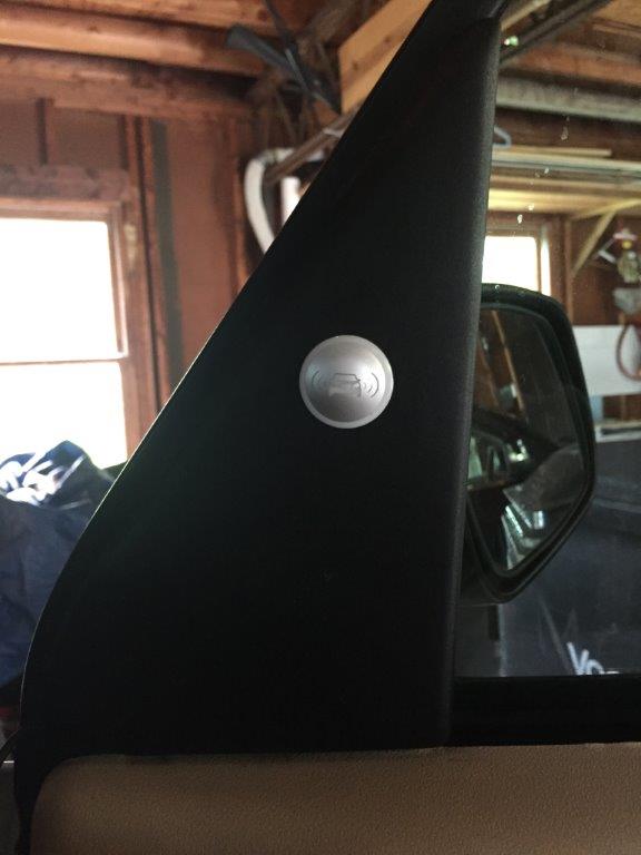

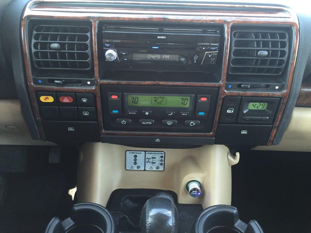

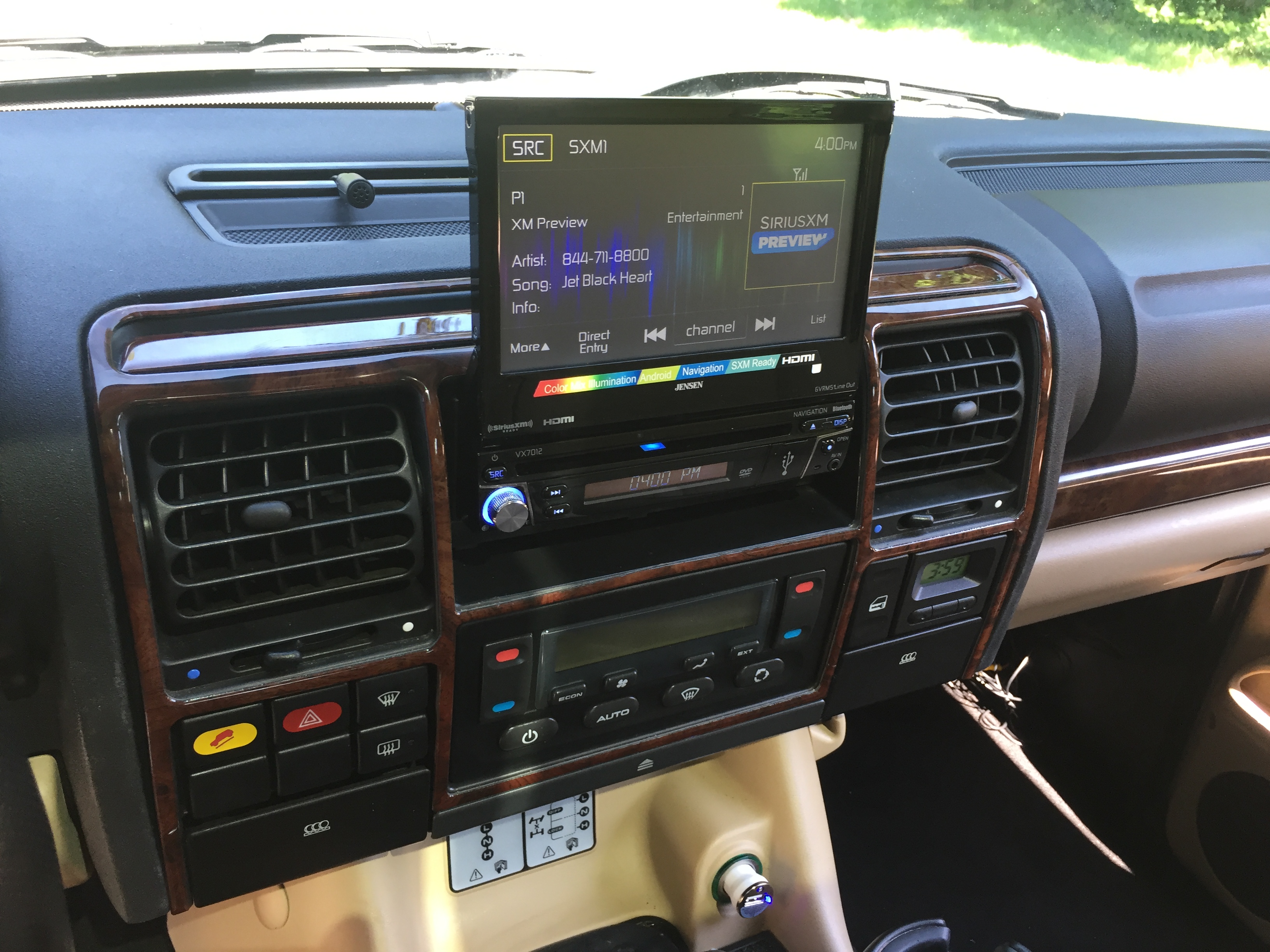

Default Jensen VX7012
I put this Jensen single DIN unit in and it sounds great.
It has it all - B/T, GPS and (with the adder) Sirius Satellite Radio.
I put the antenna for the GPS and Sirius on the flat spots on the outside top edges of the front cowl.
It took a bit to get all the wires tucked away but the unit looks pretty good.
The new radio is about a 1/2 inch deeper.
I also added Blind Spot Detectors.
Attached Thumbnails Best way to play music in a 2004 Disco?-dashboard-radio-02.jpg   Best way to play music in a 2004 Disco?-dashboard-radio-08.jpg   Best way to play music in a 2004 Disco?-right-blis01.jpg

Default Jensen VX7012 - not Pioneer AVH-NEX400
The Alpine I pulled out was a single din so I replaced it with the same size.
The Pioneer AVH-NEX400 is a 2 din. It isn't a straight swap that's for sure.
Good luck.
I also went on line and got the center dash just in case I screwed it up. I didn't so I now have an extra.
