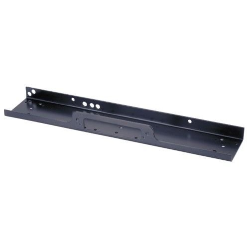

A 180$ winch mount from D.A.P. and a 299$ 12000lb badlands winch from Harbor Freight, and a terra firma (pack of 2 for 40$) d ring mount bolted to the winch mount for my 2003 D2. I didn't want to go to the expense (and weight of a full on bumper and mount), but still wanted a winch. There is a hole behind the license plate to access the winch clutch lever and the jack for the remote controller has a cut out spot on the upper left grill to plug it in. Some cutting was required of the bumper assembly parts for everything to fit and have access.

I picked up the badlands Winch tray for $49 plus a 25% Discount! ... to do the discrete setup.. its HEAVY! almost 1/4" plate steel powder coated black... i didn't see any side mounts but there was a set that was priced right at 5 bucks! i don't do any mud bogging in mine... i just want a winch for the occasional pull or out in MOAB or something! plus it looks BAD A! lol I'm just trying to decide if i really need a 12,000LB winch or can easily use the 9500lb winch...

can you please post a picture of the winch tray you used and if you have a part number that would be best as well. also id like to see a front face on view of how this tray looks on the car.
I thank you very much if you can help me
Here is link...
Universal Channel Winch Mount
