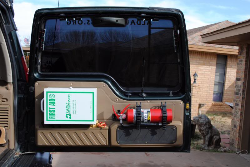

I agree.

like the "covert" antenna.... years ago vice squad in Atlanta had a confiscated "pimp-mobile" that had curb feelers that were the VHF antennas...

Wow. That is a sweet set up. Nicely done. You even have a high quality Ansul Sentry. Well done. Motivation for mine.

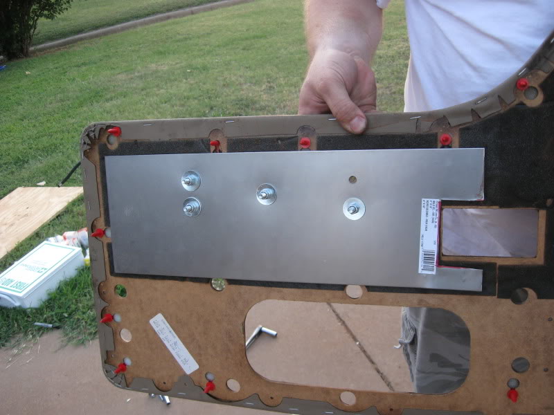

Thanks. No point to buy cheap equipment to protect your expensive equipment I thought.
If you go mounting any equipment in the manner that I have on the rear door, it would be best (... and probably required) that your reinforce the panel to hold the extra weight. Which can be done with a few sheets of metal (I used stainless steel sheets from Lowe's)
That's funny. It's amusing to see how creative some of it can get.
I just figured the back door made a great mounting spot for magnetic stuff, and it saved me from having antennas sticking up everywhere on my vehicle.

Don't mount anything above your extinguisher that could fall on the handle. Even with the pin in, with enough weight it will fire. If its mounted inside and it fires...that will be an extremely dangerous and fun day (ask me how I know). The way Street Wolf has it mounted is excellent.
