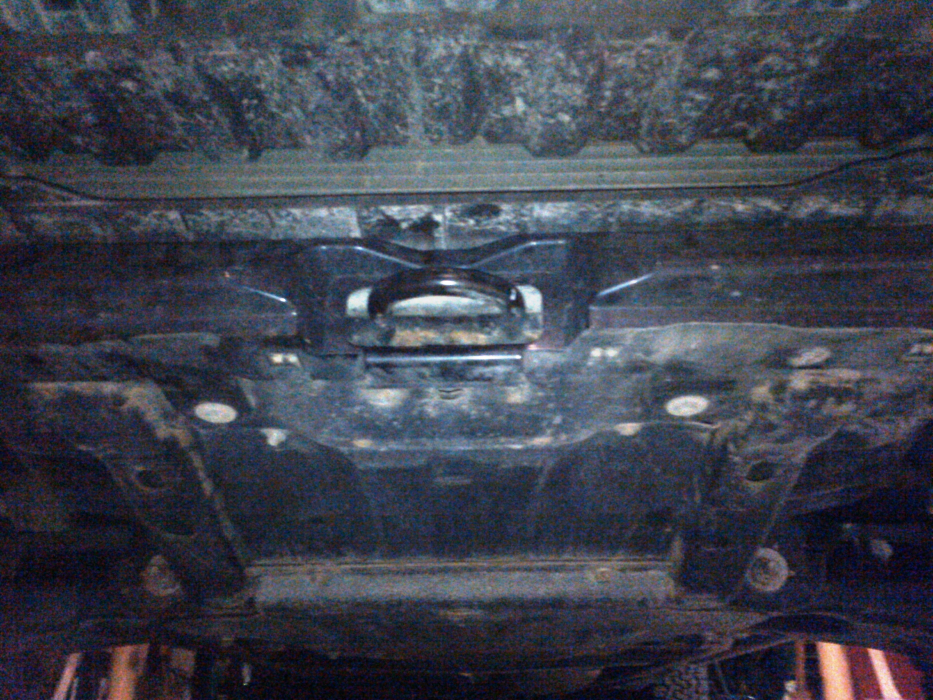

So, I went back and forth on adding a hide-a-winch or ARB front bumper. I wanted to be able to use the winch front and rear, so I bought a winch cradle and found a custom fab shop to mount a 2" receiver hitch where the tow loop used to reside:
1. remove plastic 'skid plate cover'
2. cut lower bumper on either side of the loop
3. grind off loop
4. weld on hitch (cut to fit + slight up angle to retain approach angle)
5. paint
6. reattach lower bumper piece and plastic skit plate (with hole cut into it)
