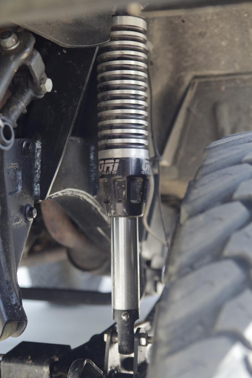

Just finished the ORI strut install on my 2004 Disco. Mark Elliot from Purpletop Garage made it all possible.
I can't believe the difference these struts make. The ride is incredible and the truck handles great even without the sway bar connected. The rig is more stable and sure footed while articulating. 6-8" ruts at 40mph are no problem.

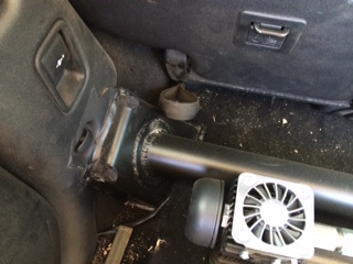

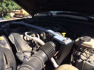

Mark from purpletopgarage.com did the install. Give him a call and he can help you get the right struts for your rig.
They are 10" struts and are close to 5" lift. Mark would be able to let you know what you would need to stay in the 2-3" area.
Since our frame are so thin he had to re-enforce the frame. The rear shock towers extend into the cab of the truck with a 2" bar connecting them to displace the forces to the top of the shock towers.
In the front we had to extend the shock towers and tied them together with a 1" cold rolled steel.
