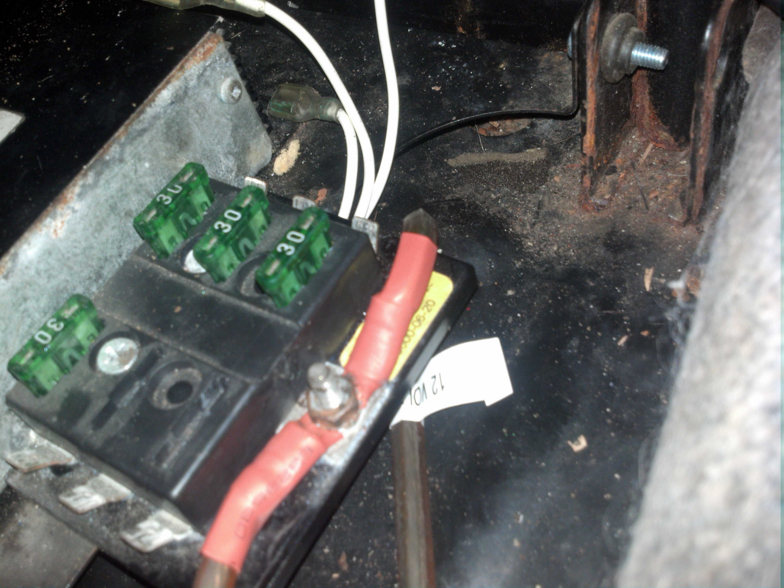

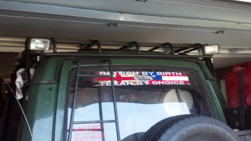

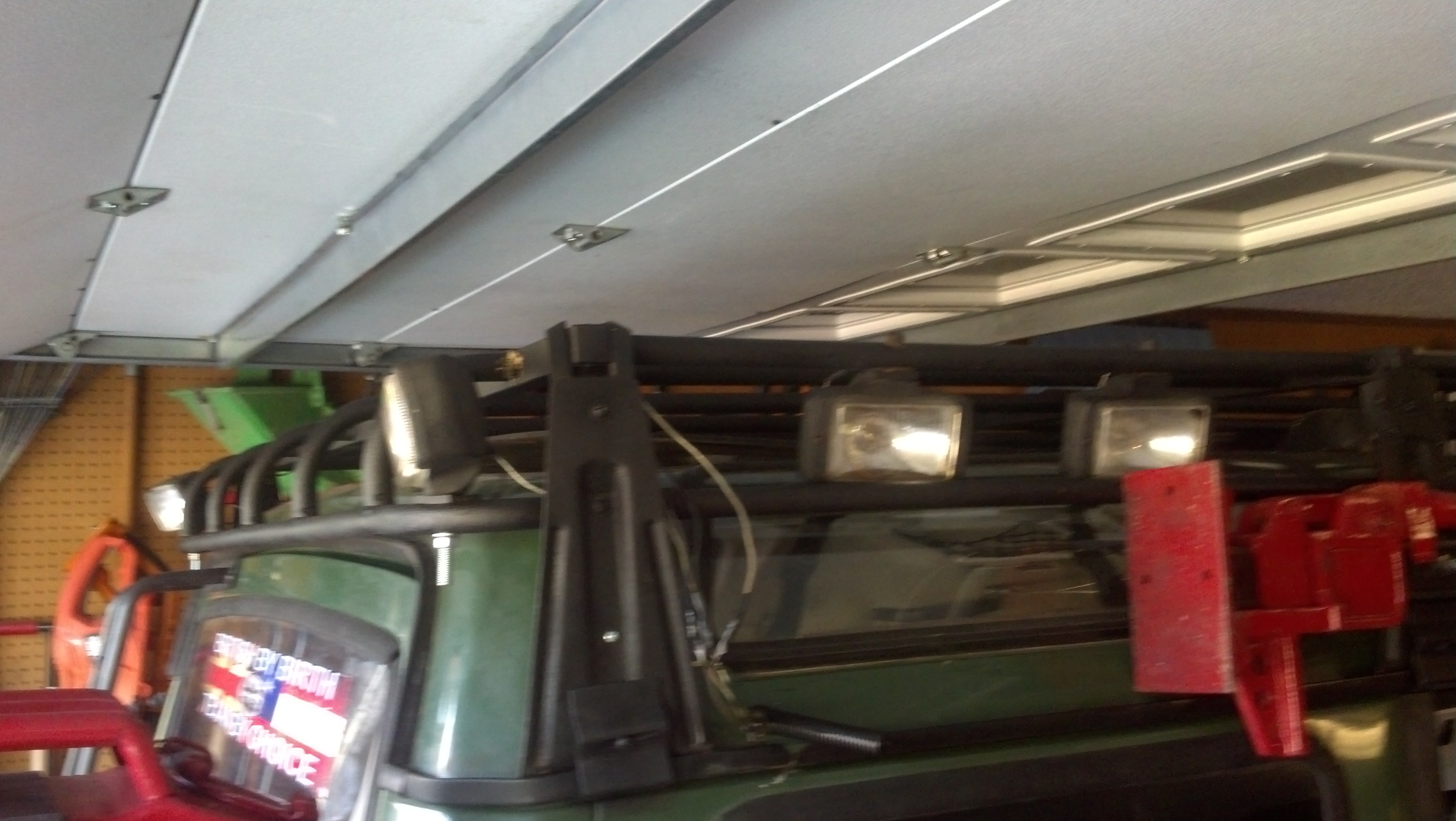

This was an upgrade and a rebuild on this system. I have had the rectangle lights for several years but I decided to go to 2 a side instead of 4 and added 2 rear lights as well.

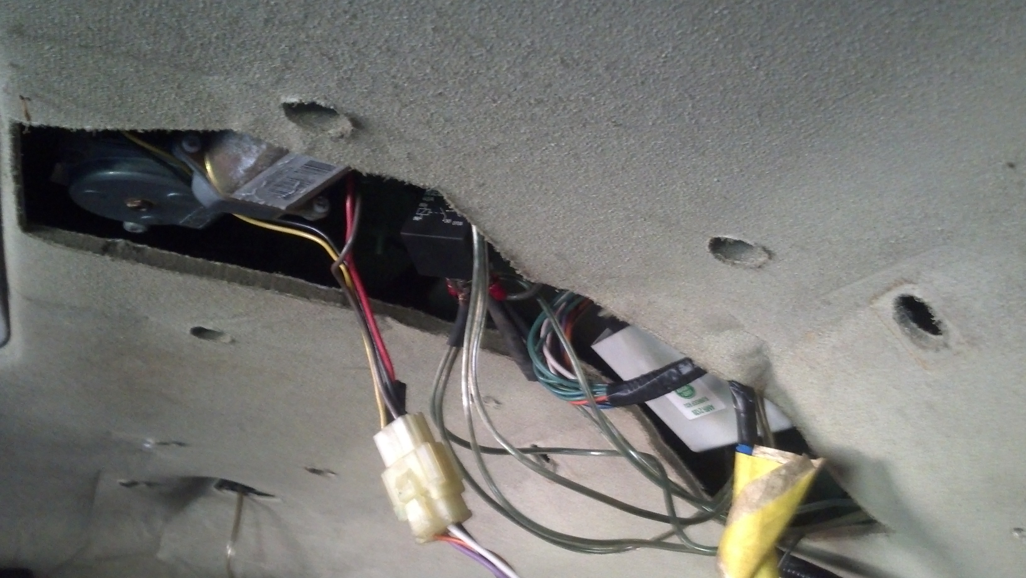

When I first did this I was on a tight schedule and did not terminate the wires the way I wanted to. So I went back and soldered all the terminations and used heat shrink on all the connections. The fourth relay is now above the overhead console as well as fused power feed. There is a small auxiliary fuse box under the seat in front of the EOM/radio amp that holds 6-40 amp fuses leaving me 3 future slots.
I took the time to go label crazy and label every wire EOM an aftermarket that I could find, including several that where future wires I installed years ago.
I also added three switches to the auxiliary light module [In the center console] so I now have light control on all 4 sides. Roof Rack Lighting Project-img_20150730_094655_737.jpg
