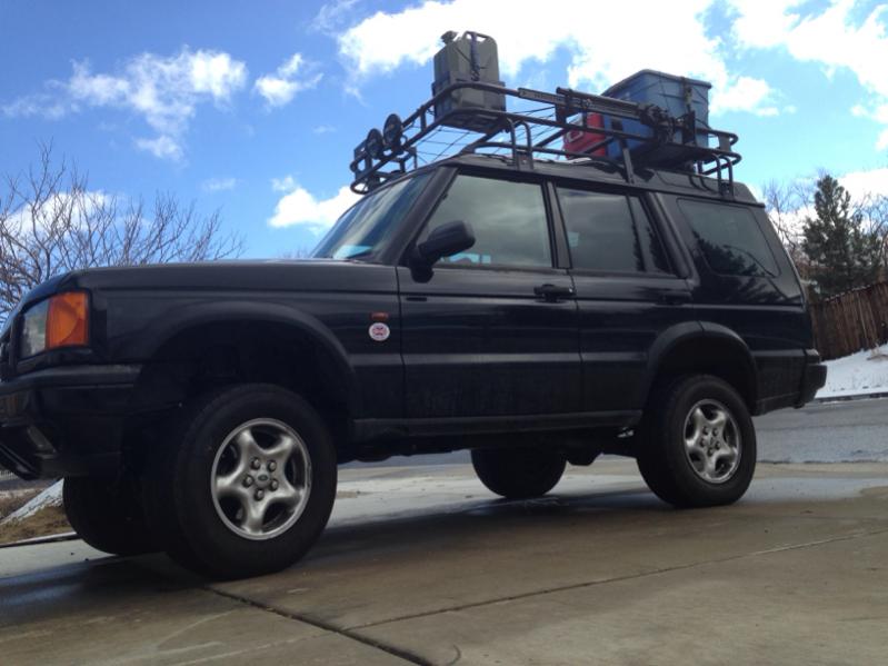

I can check mine this weekend. Just bought the car, I think its a safety devices rack.
When you say height, do you mean from rain gutter to top of tube?
Here is the rack:

My rack is a RockStar Fabrication rack. Its made with 1.25" and 1.5" 3/16" wall DOM. The flooring is aluminum C channel. It's heavier than most racks but its stout and can be used as a roof slider. Instead of 4 individual feet it has one continuous foot that runs the entire length of the gutter. This provides better weight distribution and rock solid attachment.
I'd recommend looking at different racks like mine, the SD/Voyageur, Baja Rack, Hannibal, etc. Then build the one you want.
