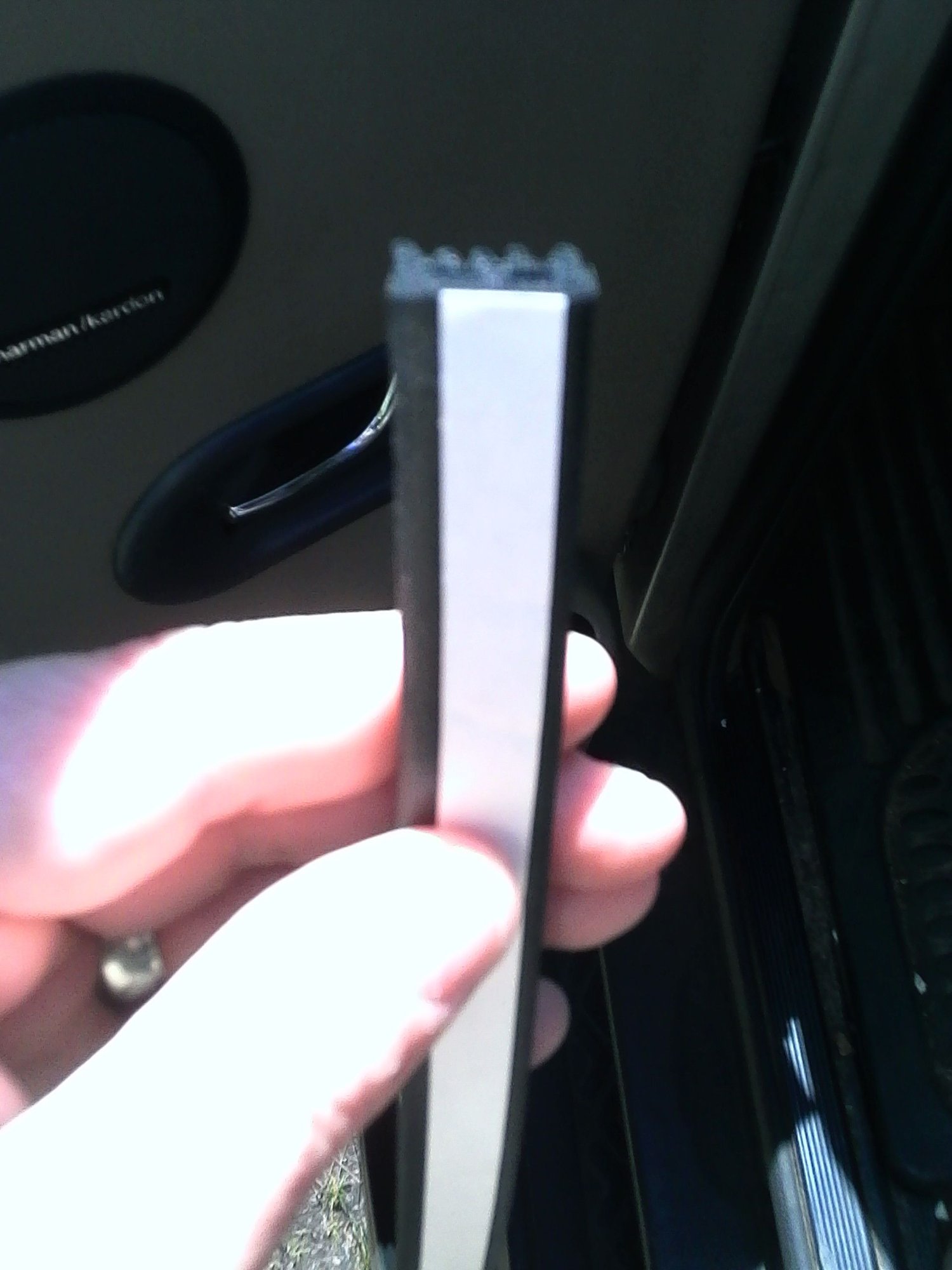

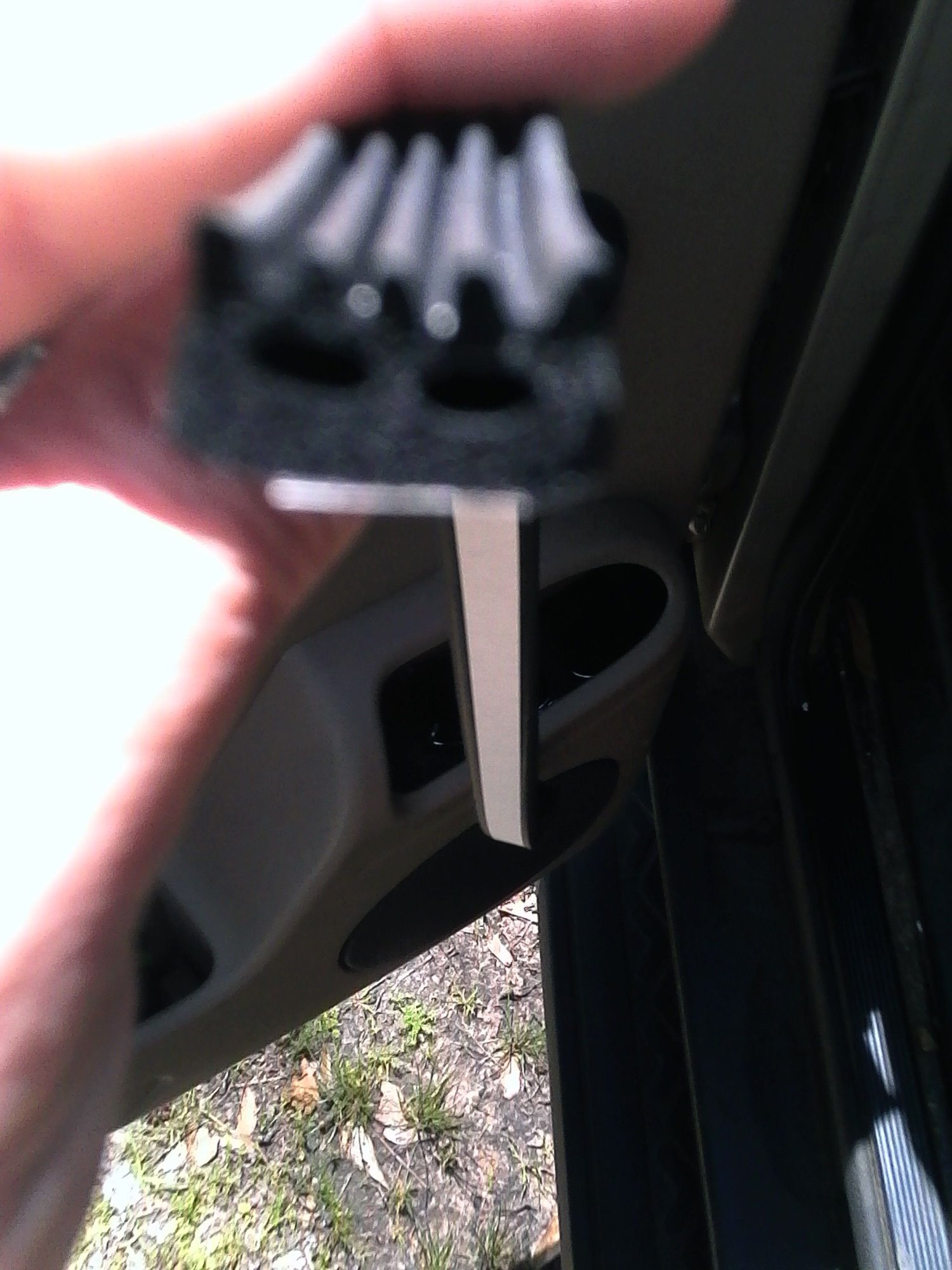

It was wider than the original seal and has a wider adhesive strip so I hope it will last a lot longer and at least keep out the rain.
Nice wide adhesive strip.

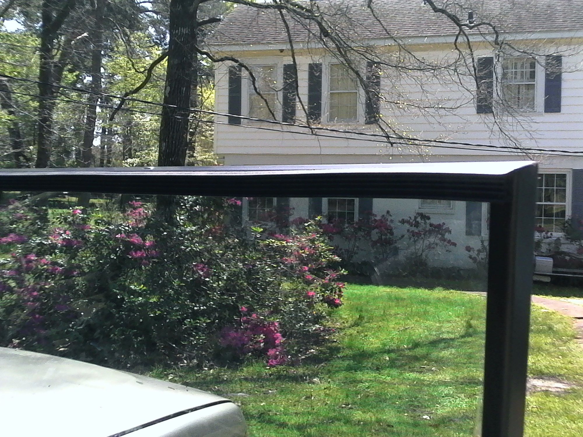

I first put on the top seal. Then I placed the end of the 2nd seal under the top seal and ran it down the door to the rubber molding and cut it off there.

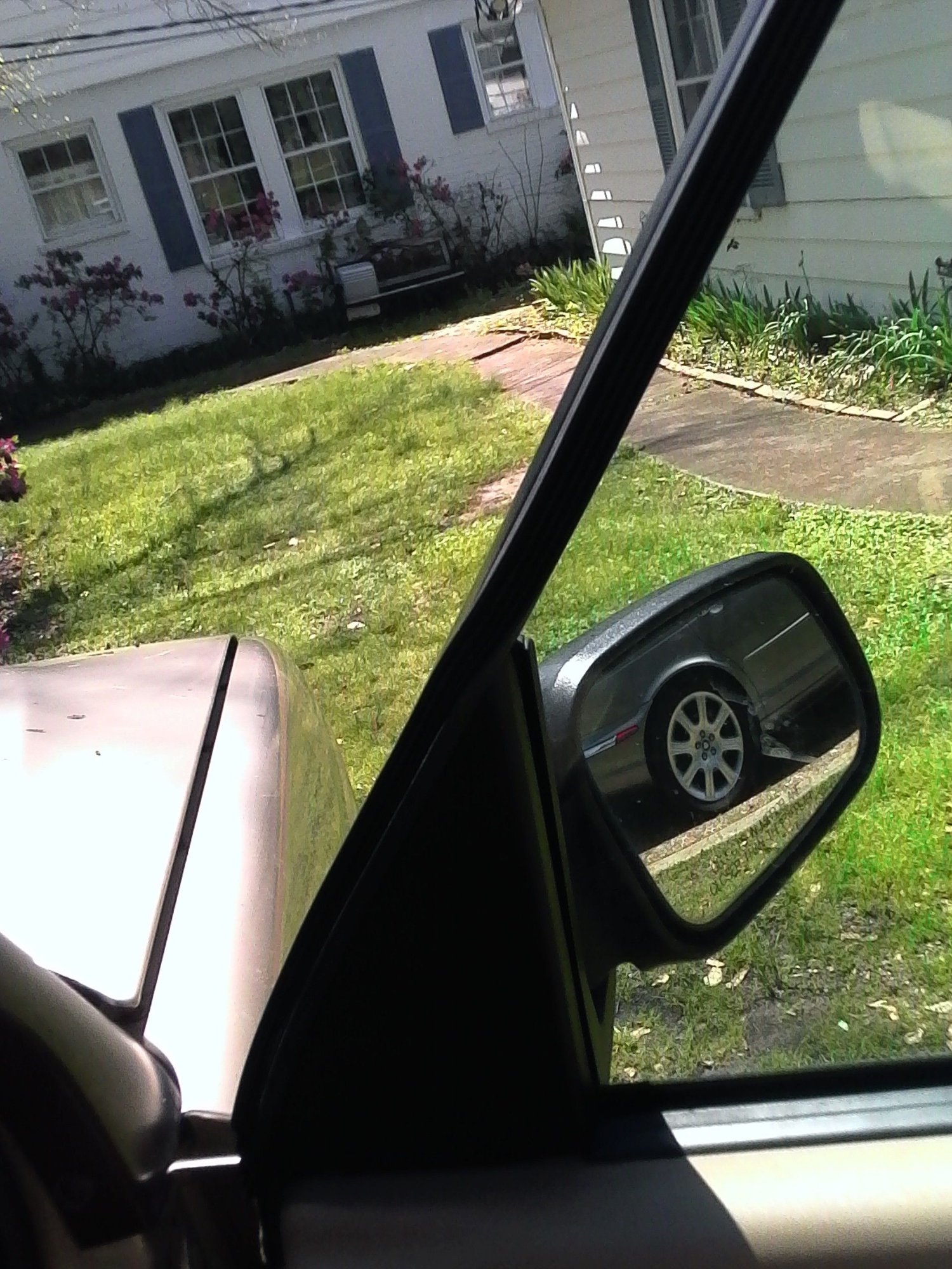

I cut this at a slight angle to go along with the door frame.
I thought I would try to run the seal down the door past the trim or insert. It seemed to stick OK because of the wider adhesive surface of the seal. Time will tell on this one. I can always cut it off later if I need to.
