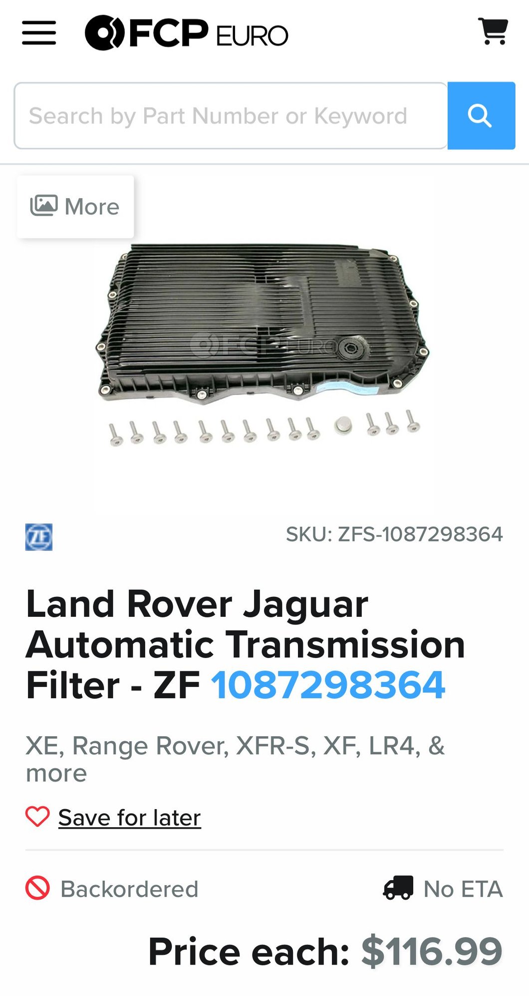

The OEM ZF pan runs about $100 and needs to be changed out as the filter is integrated. 5-6qt's of fluid will be around $100-120 ish.

I'm also told the LR ZF pan is plastic. Is that true? Basically I'm told all ZF pans atlre plastic and the Disco doesn't need the metal ZF pan because of the rock guard/skid plate already protects the transmission.
Am I being lied to by the local mechanic? Or does he just not know anything - and should I run away from this shop?
I think I just found the answer to my own question, so I'm adding it here. The pan might be aluminum per the ZF oil change kit document. There are two columns for the pan and column with circle 1 is aluminum and column with circle 2 is plastic.
This explains why the Land Rover pan is more expensive but I've been told the BMW pan is also available in aluminum and costs less so I'm going to check into that. Not sure if the filter on the LR pan is different than the BMW pan.

I have replaced mine with the fcp euro pan. Both the factory original (I bought my 2017HSE Si6 with 13K miles and it was never owned except by the LR dealer I bought it from) were plastic and identical. I have had no issues since this replacement over 10 K miles ago.
