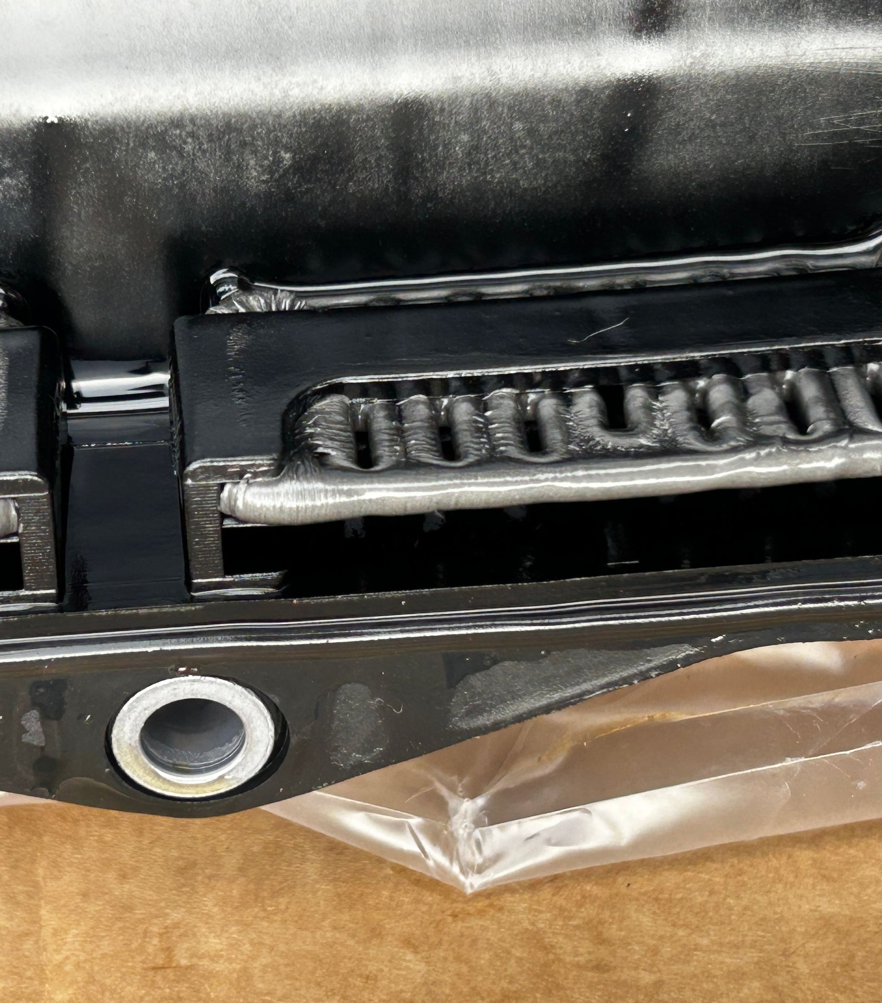

FWIW... Even though my independent mechanic said that the pans are plastic because they have a rock shield anyway, and the ZF documents are calling for aluminum, I am just going to post this photo here which shows the rock guard over my transmission on my 2018 HSE Lux.

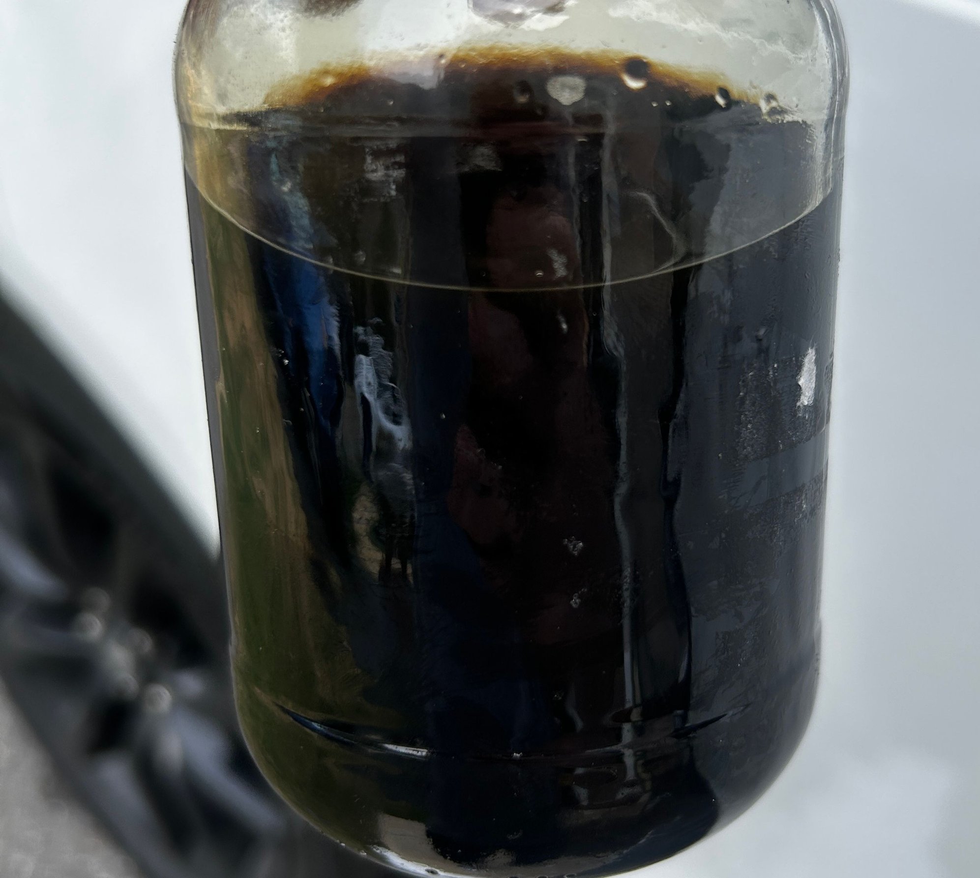

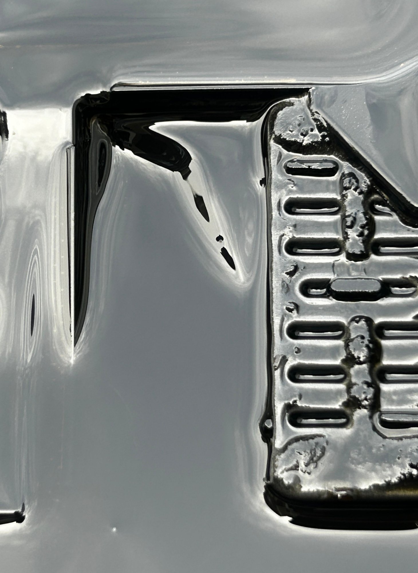

Finally got to change the pan and fluid today. Fairly straightforward refilled and reset. Will see if it solved the issue I was having.
Pan magnets
Pan magnet
Original fluid 125k miles
Pan magnet
Pan magnet

Update: it’s been about 1,000mi after the pan and fluid change. The specific problem has not reoccurred. Most of gear shifting seems smoother, but there is something going on (that I can only described as hesitation/slight vibration) when shifting from 5th to 6th gear in D-mode at 40mph / 2000rpm. Almost feels fuel related but it doesn’t happen at any other speed/gear.
