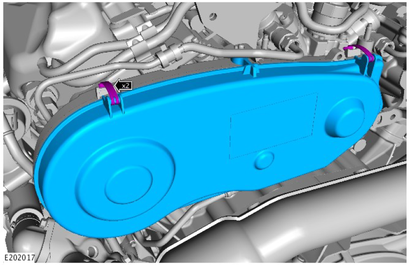

The high pressure fuel pump is located between the cylinder heads at the back of the engine and driven by a belt and tensioner from the exhaust camshaft.
Behind this cover.  Not easy to get to.
looks like fun.
one thing to note. When this happened I was able to limp home/ engine would start (about 5 miles)
now engine will crank but no start. If this were a pump belt issue, would I have been able to make it home?
