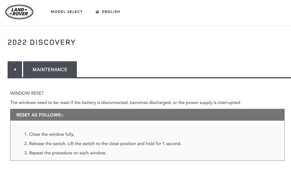

1) One touch drivers widow not working. They actually replaced the regulator and other parts in the passenger rear window due to a TSB, and the drivers window not working correctly but have request out to LR for help
