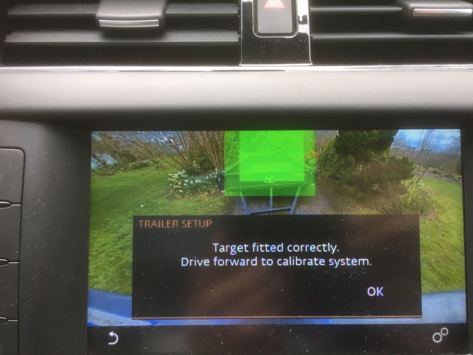

I have mine on a tandem box trailer.
The problem is that the sticker is right on the lower limit of the sighting box and most of the time its not picked up. This is a real nuisance as almost every time the trailer is connected it wants to recalibrate which means I constantly have the calibration messages on the screen and no clear view of the trailer.
I have on occasions had the system calibrated correctly and then it works well with plenty of room around the car, but real caution needs to be applied if backing using the rotary **** in a tight situation as the nose of the car needs plenty of room.
When calibrated and steering using the steering wheel the guide lines are helpful.
Is it possible to have the green sighting box moved down?
The alignment of the camera is correct.
