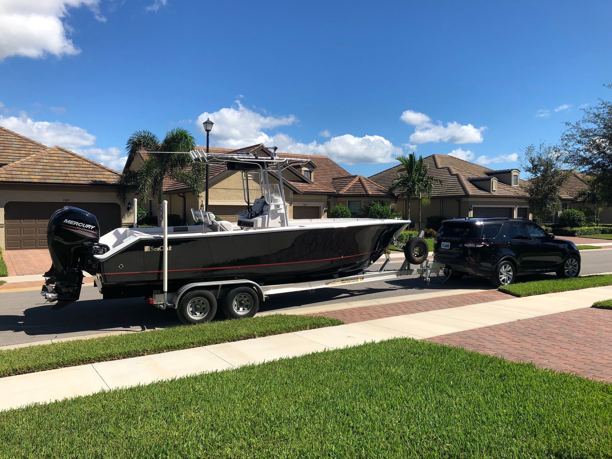

I tow a 25ft Sea Craft with twin 150 4 strokes. Truck scale has it at 6900lbs light. With a full load of fuel and gear its probably close to 7400 lbs. I’ve towed this rig with a Chevy 1500 PU, A Tahoe, and a V8 Jeep Grand Cherokee . The DIscovery tows much better than all and its Gas. The truck is steady , sure footed on highway, and has more power than all the V8’s mentioned. Put it in S mode which changes the gear ratio a bit and I can pull it at 75 mph no problem. My trailer has disc brakes on both axels and I have a lot of experience towing. It’s not a 3/4 ton diesel pickup and I dont expect it to be. It’s more than capable of towing my boat 2 or 3 times a year 200 miles to the keys and back. Boat ramps are no problem. Forget about fuel economy in the Gas D5. Diesel is probably a little better. Don’t over think it. It’s the best towing rig in its class.

If your trailer is set up properly you shouldn't have any hitch bounce. The Air suspension is self leveling so it self adjusts to the correct ride height regardless of tongue weight. This pic is when I towed with my first Discovery 2018. I have lift rods on my 19 and 33inch tires and it tows great.
