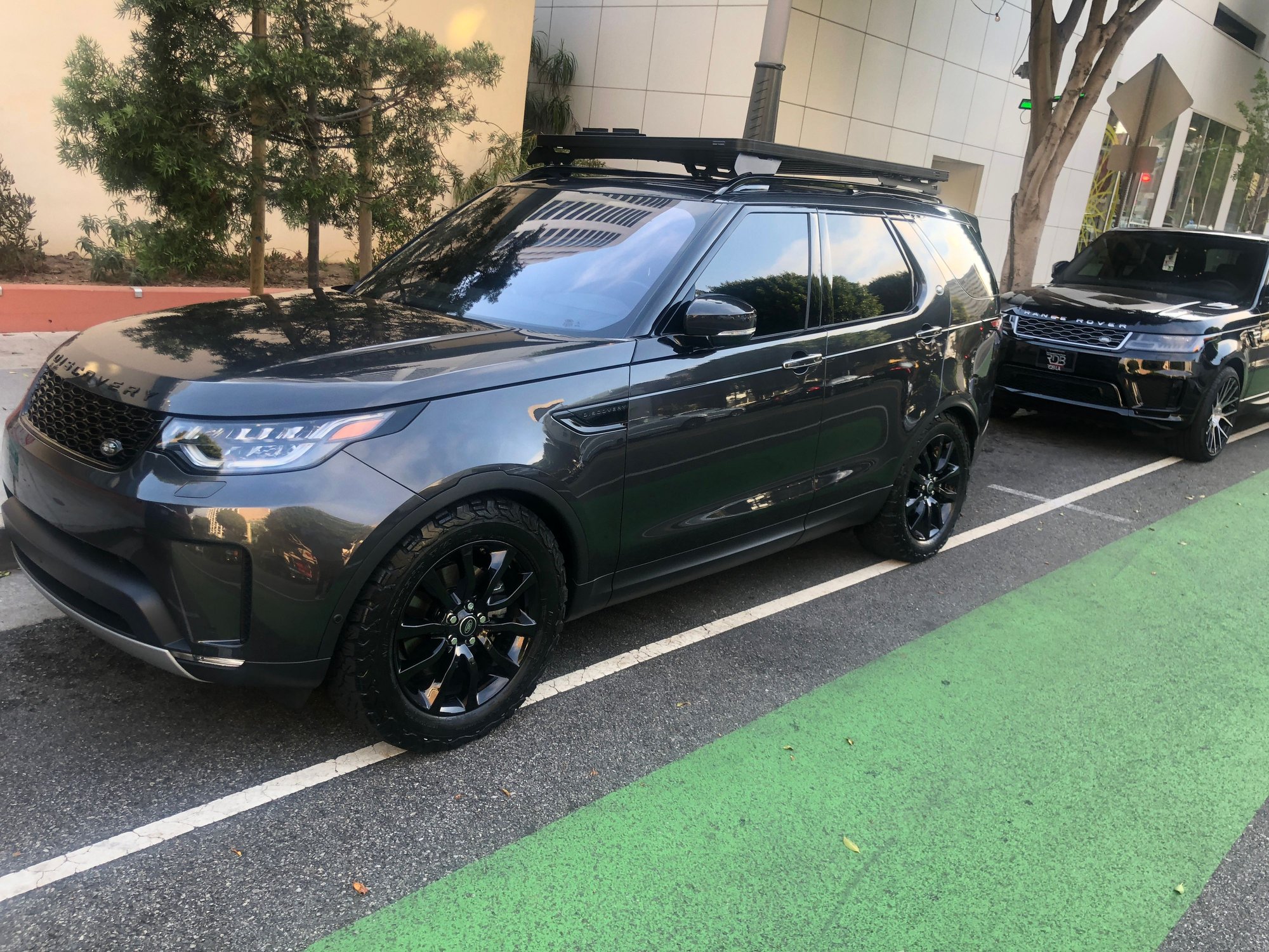

I found some 20” RRS wheels on Craigslist and put BFG KO2 275/55/20 on them as my second set. No lift and it works just fine. I also leased so keeping the original set on hand when I turn this one in. Picked up wheels and tpms for $950 which I think is a steal as the 20” LR wheels retail at $1600 and $900 for tpms. KO2s look awesome on the D5 as well and much better for off-roading/snow!

JR- you must have photoshopped that picture because according to the guys on the LR4 forums, the D5 is just an Explorer looking minivan and not capable off-road.

Thanks everyone for the input, sorry for the super late reply... Good advice. Love your wheels Earthsurf, very cool, that is how all the Disco V's should come from the dealer. Much better stance, more rubber..

Originally Posted by EarthSurf
Hey Bud,
looks sharp!
How did you handle the overall larger diameter on speedo? Did you reprogram?
Did the tpms just learn to your car?
