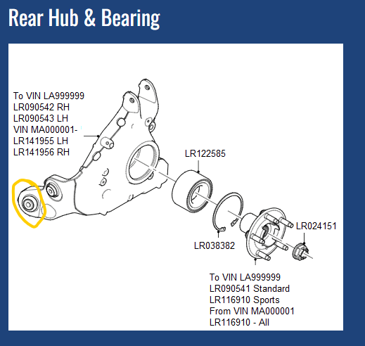

Hi,
Has anyone replaced the below bush on a Discovery L462 its the rear drivers side. i cant find the part number anywhere and dont want to but an entire hub:

It looks like it's part of the assembly. You may want to see if its listed with the lower control arm assembly, but looks to me that it's a part of that bracket. I hope I'm wrong as the individual bushing would be way less $$ than the bracket.

Do you have a picture or video of the worn bushing/knuckle?
How did you determine that circled bushing in the picture is the problem?
