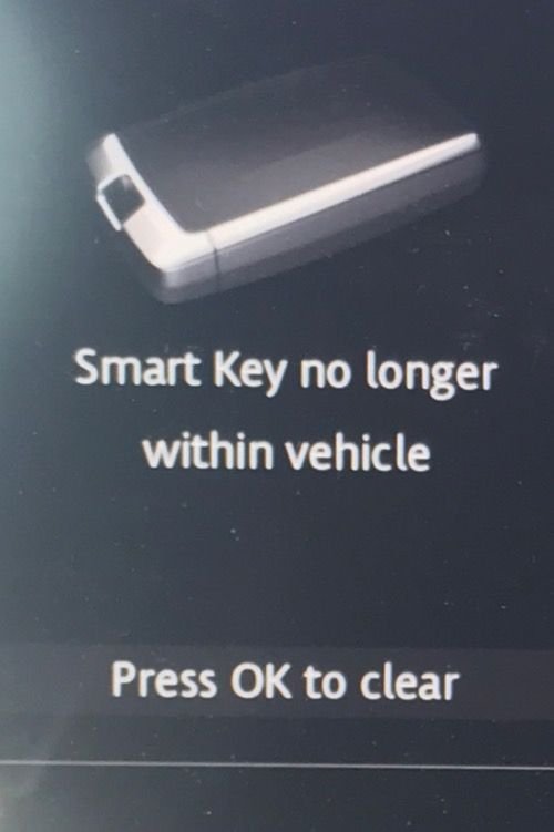

Got my Disco back. Two of the transmitters for the key-less entry / push-button start failed the diagnostics test and had to be replaced. Reading through all the notes, they weren't were they were supposed to be and they had to take out the headliner, part of the dash, and the C-pillar cover. The good news is that everything is working, the bad news is they cracked the plastic on the C-pillar and broke the handle in the 3rd-row/cargo area. All parts are on order, but coming from UK and 10 day wait. Other than that I've got my truck back and everything is working.
It's worth noting that the "Smart key no longer within vehicle" message came up a few times before the transmitter failed all-together and the car wouldn't start. If you see that message, get it in and they can do a diagnostics on the transmitters.
