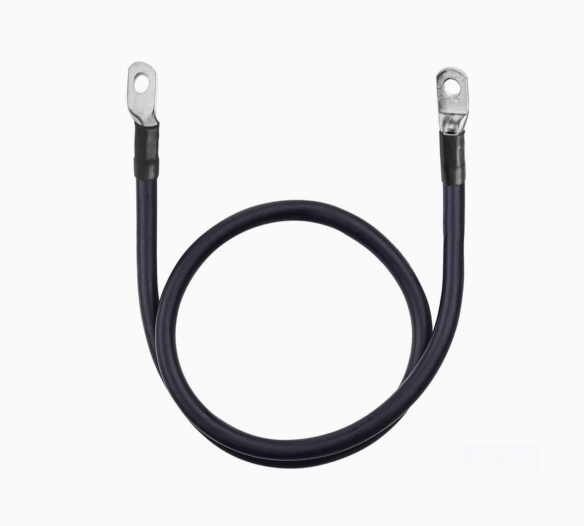

What gauge wire did you use?
I used 4 AWG wire.

So @Hatem who worked this fix out a massive thank you!!! You saved my @55 big style. Drove from the UK to Italy and the Battery warning started to show... was okay for a few days until it wasn't and the car just died in a campsite.... AA roadside assantence jump started it started and got going! Any way long (hot and frustrating) story later and a £4 ground extension has sorted it.
