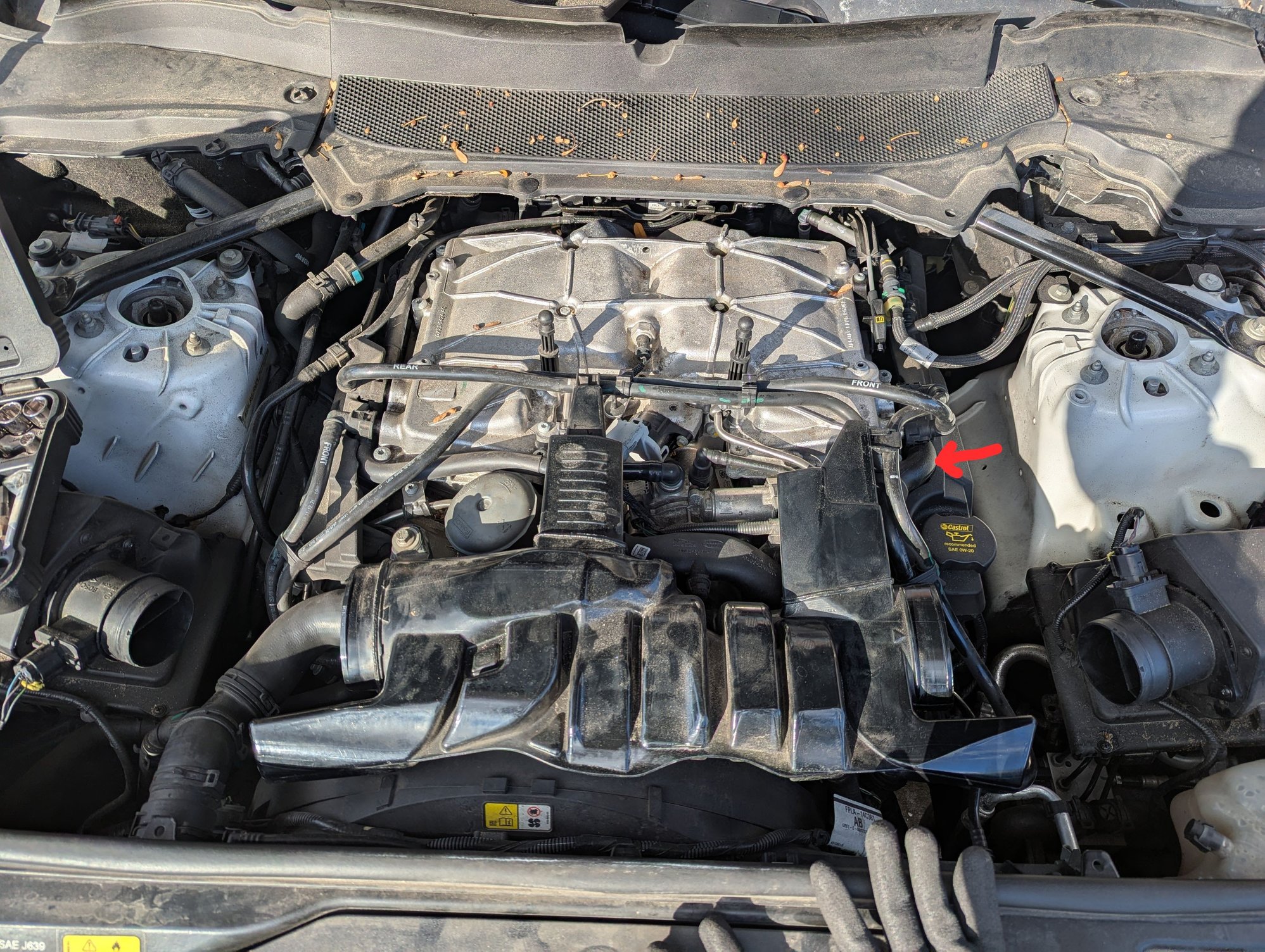

Update.
Thanks go to @Canes173 for helping march through new parts to see what solves this issue. He now has a working vehicle, last I heard anyway. His fix (new fuel pump relay) did not work on mine though, still dying after starting, and dying when accelerating at low speeds. Seems like a only at low RPMs.
I thought I would do a little cleaning around the air intake piece. Cleaned both MAF sensors. I was going to look at the throttle body but determined after looking at what I faced I needed about 4 hours to do it thoroughly, and didn't have that time to spare. When looking around I noticed a hose that comes from either the engine or the supercharger back to the air intake was only butting against it intended connection. I tried to get the hose and cclip to connect but there was simply not enough length to get the connection to click. Thinking now maybe this is a vacuum leak. For a temporary fix/test I wrapped the connection tightly with black electrical tape to see if that would seal it to some degree. I have no idea what the hose is intended for if not simply a vacuum hose. I have included a picture showing the hose coming from under the supercharger. If anyone knows what this hose is I would greatly appreciate knowing it also.

The temporary tape job did not work. Obviously, that possible leak may still be a problem. Up next - smoke test.
Turns out the hose is a breather hose.
