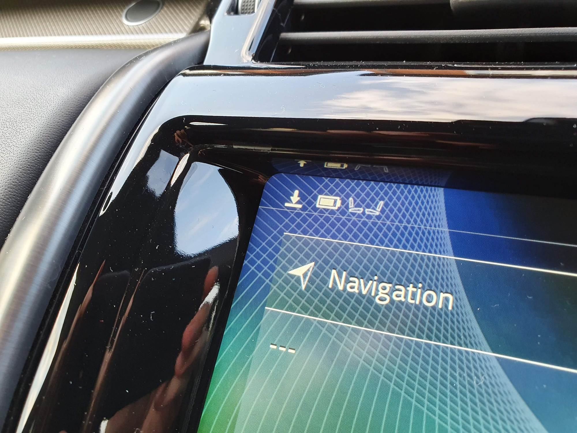

Hey folks. I picked up an approved used MY18 a couple of weeks ago and decided to update the incontrol software whilst having a play with the new car. The software updated successfully to the latest 19c version and thought no more of it. I also updated maps. A day or two later I got a little download symbol (downward arrow pointing at a horizontal line) appear in the top left corner of the display.
I've checked if there are any updates available but I'm fully up to date on everything, and the download symbol won't go away. Anybody had the same issue or know what I can do to get rid of it? It's driving me mad!

Just in case anyone else gets the same issue, it persisted for 2 months, until last week it looks like it's been cleared following the latest update S20a_20.16.5-536345. Very odd but at least it's sorted.
