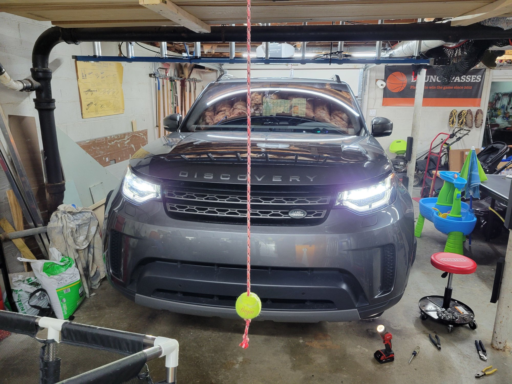

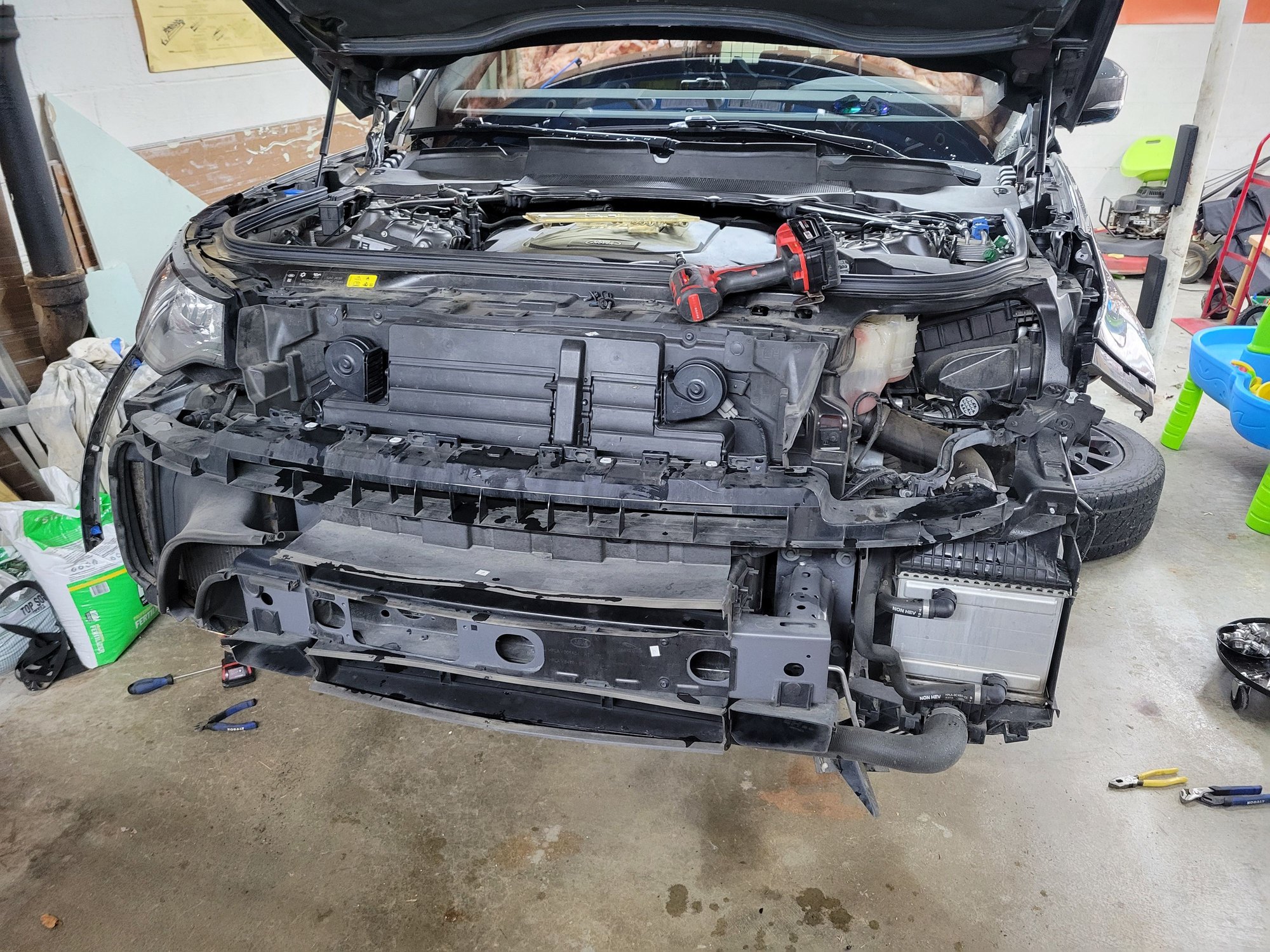

It works! Tested all functions and we appear to be working 100%. Now for the fun of removing the bumper and swapping them out.

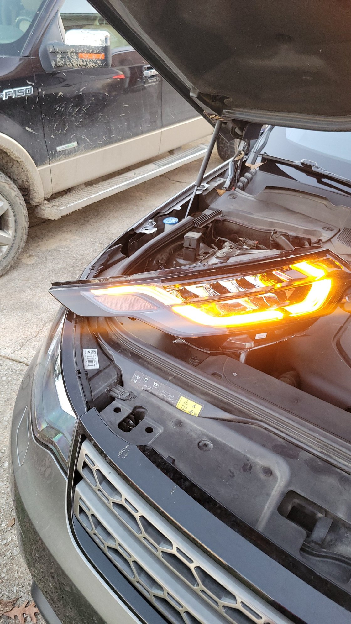

Got everything installed, and the DRL were orange when in gear. Had to change the "DRL type" with the GAP tool to "dedicated DRL" and now it functions as it should from the factory. The adapter harness requires an extra power wire, so I tapped a fuse in the engine compartment fuse box, easy enough. Visibility drastically improved! Aesthetics aside, the halogen lights suck, can't see anything!
